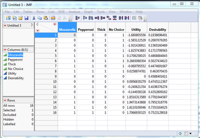

However, now that I have had a play around with them I have come across a problem - for me at least and perhaps for others too.
If you change which indicator variables (attribute levels) are include when you run the model the value of both the utility and X2 change fairly dramatically.
So how do you interpret the value of "none"?
For example if you include "Mozzarella", "Pepperoni", and "Thick", the Utility value of none is -1.68 and X2 is 15.025, which is great and can be interpreted if this value doesn't change when you change attribute levels, however if you include a different combination of attribute levels lets say the inverse "Jack", "None" and "Thin" it takes on a completely different set of values for none Utility is now -3.29 and X2 is 76.703. Yet the AICc and BIC remain constant as does the -2*LL, and as expected the inverse values for the utility of each of the levels that were included compared to the first run.
Intuitively this seems wrong... as the first combination of levels of the alternative are much more favorable than the second yet the utility for none gets less for the less favored combination, yet the X2 increases, suggesting it is more weighted in the analysis?
I looked through the results a number of different ways and exported a data table from the profiler which I think highlights the problem (perhaps)...
The attribute parameters appear to being estimated twice once with none and once without? Shouldn't there only be 9 profile estimates, the 8 alternatives plus none/no choice (coded as 0 0 0 1)? If I am wrong could you please explain how I should interpret the none in your examples?
Thanks so much this is very helpful!!

Hi, Jasha. The problem in your output data table is that you set "No Choice" = 1, and then you set attribute levels for the other variables.
The "No Choice" column isn't a comparison. The Choice platform treats it like another factor. When you set up your profiles table, you should have a "No Choice" product that has 0's for everything except the No Choice factor: All of the other products should have 0's for the No Choice factor. Like this:
Notice how the "No Choice" column is all 0's except for the last row in the table? Notice also that that row has all 0's for the other factor? The last row in the table is the "None" or "Competing" product.
Hope this helps!
Melinda

Hi Melinda, many thanks for your response.
I definitely understand what you are saying here, however, my profile table is set-up as you have suggested with the "No Choice" column as all 0's except for the last row in the table, this is because I have used the files you attached above a few months ago.
The resulting output table from the profiler is generated when I use your original profiles table with the none option set as an dummy variable, and the toppings each as dummy coded variables, and I run the analysis as pictured.9716_Capture2.PNG
And I get the following basic output table:
If I change the combination of toppings or crust type estimated along with no choice, the value of no choice changes in terms of X2 and utility where as the toppings and crust (because they are binary in this case and dummy coded) just change sign i.e here I have changed "Jack" for "Mozzarella" only and as you can see the no choice option has now changed values:
So I'm not sure how to correctly interpret no choice? I am sure perhaps I'm overlooking something, but I can't see what that is?

Just like in the profile table, settings in the Utility Profiler that include No Choice =1 and other factors also set = 1 are not interpretable. JMP doesn't know that it's impossible to choose "none" and also choose Pepperoni=1, so when you use "Output Grid Table" (I assume that's how you got the table in your initial question) JMP shows all possible combinations of factor settings.
So, the only rows that are interpretable in your output table are Row 1, and Rows 10-16.
Re: Choice platform, "None of these options" alternative - how to handle?
Brilliant, that answers my question perfectly. Thanks so much
