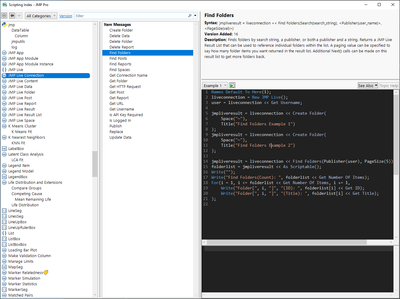

Did you try dropping this part from the Find Folders
Publisher( user )

I'm not familiar with JMP Live, but have you tried increasing the page size for the query (or utilized Next() call)? Scripting Index can have some examples which you cannot find from JMP Help page
Publisher( user )
-Jarmo

Thanks for the suggestion. It turns out to be the winner!
This code (adding the Search function as a parameter to the Find Folders function):
// open the connection to JMP Live
liveConnection = OpenJMPLiveConnection( );
foldername = "foldername";
// get the existing folders already in my Space
getFolders = liveConnection << Find Folders( Search( foldername ) );
folderlist = getFolders << As Scriptable();
Show(folderlist);
returns the name, description, ID and URL of the folder if it exists outside my personal space.
