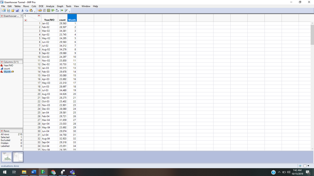

Thanks for your help.  Here's a pic of my data set.  It is the column Year/Mo that I am trying to get to show chronologically in graph builder.  Screenshot (9).png

Because your rows are in the order you want your chart, you can simply handle this by turning on the "Row Order Levels" Column Property for your "Year/Mo" column.
To do this, move your cursor to the column header for the "Year/Month" column. Right click and select
Column Properties==> Row Order Levels.
The order of the axis for any charts you make for that column, will then be in the order the data are in the data table.
Jim
