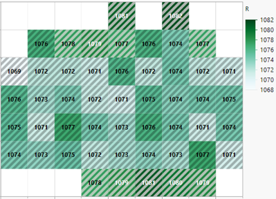

Change color pattern of filtered data on heat map
Data is filtered.
Resulting plot of data creates pattern on heatmap that is not solid color but striped.
This pattern is too bold. Is there a way to change it or remove it?

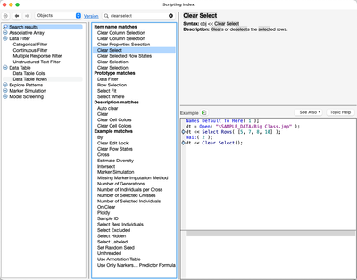

The << Clear Select message to the data table will clear the selected rows.
Names Default To Here( 1 );
dt << Select Rows( [5, 7, 8, 10] );
Wait( 2 );
dt << Clear Select();
-Jeff

It looks like the pattern that appears when you have rows selected. If you go back to your data table and clear out the rows that are selected (ESC key), the pattern should go away in your graph. If you then select specific zones on your heatmap by clicking on them, the pattern will return and the rows will be selected in your data table.

Are you aware of a way to do that programmatically in JSL?
I have a large amount of plots that are generated and having to do this would slow things down.
Wait( 2 );
-Jeff

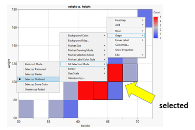

If you want to use the selection feature but make the selection less visible, you could changing the style of how selected items apear in the heatmap:
dt << Graph Builder( Show Control Panel( 0 ), Variables( X( :height ), Y( :weight ), Overlay( :sex ) ), Elements( Heatmap( X, Y, Legend( 3 ) ) ), SendToReport( Dispatch( {}, "Graph Builder", FrameBox, {Fill Selection Mode( "Selected Outlined" )} ) ) )
