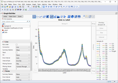

frankderuyck
Level VII
Cerate a parallel plot with NIR data
With gaph builder I would like to create a parallel plot with NIR data. I have tried but I get a very messy graph as shown in attached file, how can I make this plot like the one in the functional data explorer?

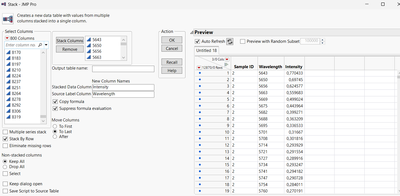

You will need your data in a stacked format to realize a similar plot with Graph Builder.
Here are the steps to have the graph you want :
  1. Stack your datatable (all the wavelengths columns), change the names Label and Data as "Wavelength" and "Intensity" for example :
    Script for this operation :

    	Source Label Column( "Wavelength" ),
    	Stacked Data Column( "Intensity" ),
    	Output Table( "Stacked_table_NIR" )

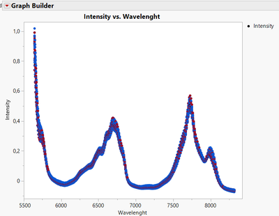

  2. Change the data type and modeling type of "Wavelength" as Numeric and Continuous.
  3. Use Graph Builder, set "Wavelength" as X, "Intensity" as Y, and you'll get the Graph :
This graph is not a paralell plot, as a paralell plot has "independant" scales for each variable to allow for better pattern detection/recognition. More infos here : https://www.data-to-viz.com/graph/parallel.html
You can find attached your datatable, with the scripts added for the stacked table and the Graph Builder (script in the stacked table).

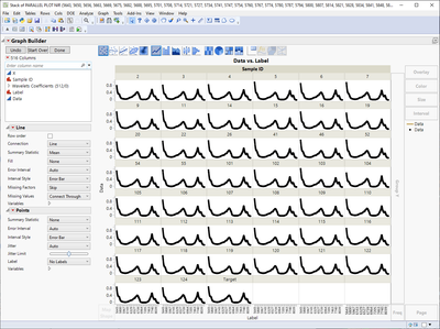

Which plot are you looking for? I don't see parallel plot in your functional data explorer script
Are you looking for something like this?
or this?
(these have been created by first stacking the data)
-Jarmo
