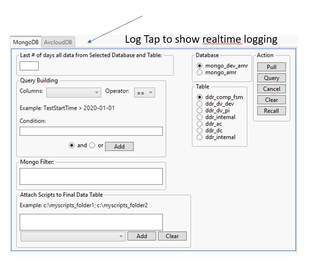

I'm trying to capture the logging information into new window. Following code isn't showing anything in new window.
This is a first step towards an integrated GUI where "log" is also a tab and can be checked instantly to view logging instead of going to JMP logging page which is separate window.

My problem is, I'm trying to have another tap in my integrated gui where realtime logging is seen. So that user can just click that tap and see the og instead of going to another window.
