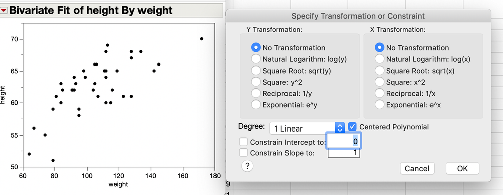

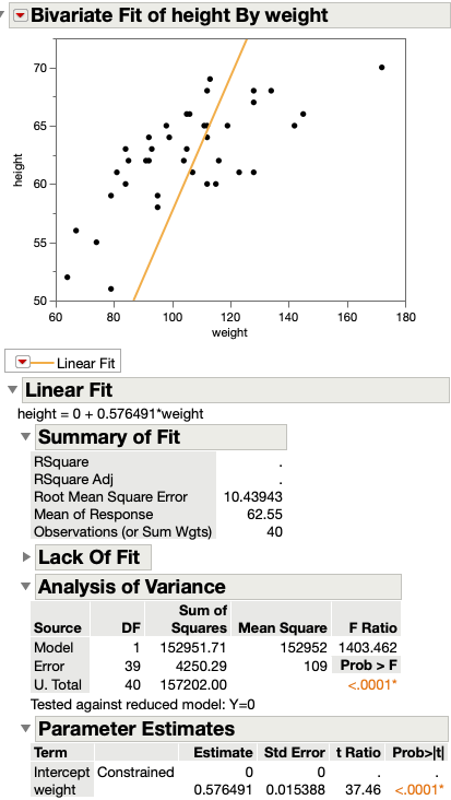

Yes, but No.  Use the Fit Special option
(earlier I added the wrong screen shot)
The thing is, when you fix the slope or intercept, then you're not really doing a least squared fit.
Since RSquare is the sum of squares for the model divided by the total sum of squares, there isn't exactly a model to work with for the fit.

Caution! Care must be taken when interpreting an RSquare value with the intercept forced to be 0. The usual statistics like RSquare assume that you are using the mean of the response (Y-bar) for your sums of squares. By forcing the intercept to be 0, you are replacing Y-bar with 0. This alters the typical interpretations of those statistics. How much is altered will depend on how far your Y-bar is from 0.
For example, it is possible to achieve a negative RSquare value when you constrain the intercept to 0. For this reason, most people are in favor of not reporting RSquare in such cases.
