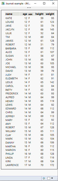

Here is an example of how I have done this in the past....it is a little bit of a kluge, but it works
names default to here(1);
dt=open("$SAMPLE_DATA/big class.jmp");
myjournal = dt <<journal;
wait(0);
nw = New window("example",<<journal, bb = border box(top(1),left(10),right(1),bottom(1),
	sides(15)
bb<<append(myjournal);
myjournal << close window;
xx=nw<<get picture;
Jim

Thanks @txnelson . That will work for sure. I ended up making the summary tables using Python scripts instead. I found them to be a bit more user friendly when exporting tables to a powerpoint.
