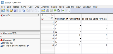

txnelson
Re: Can we use "for loop" in Column Formula ?
Here are a couple of ways to create the column you want
Names Default To Here( 1 );
dt = New Table( "custIDs",
	New Column( "Customer_ID", character, values( {"c1", "c1", "c1", "c2", "c2", "c3", "c3", "c3"} ) )
dt << New Column( "Or like this" );
counter = 0;
For( i = 1, i <= N Rows( dt ), i++,
	If(
		i == N Rows( dt ),
			counter++;
			:or like this[i] = counter;,
		:Customer_ID[i] != :Customer_ID[i + 1],
			counter++;
// or
dt << New Column( "or like this using formula",
	formula(
		x = .;
		If( Row() == 1, counter = 0 );
		If( :Customer_ID != Lag( :Customer_ID, -1 ) | Row() == N Rows( Current Data Table() ),
			counter++;
			x = counter;
		x;
Jim

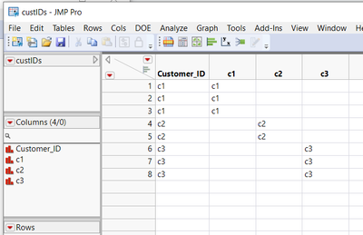

txnelson
Here is one way of doing it
		character,
	If( i == 1,
		dt << New Column( Char( :Customer_ID[i] ), character );
		Column( dt, :Customer_ID[i] )[i] = :Customer_ID[i];
		If( :Customer_ID[i] != :Customer_ID[i - 1],
Jim
Hi Nelson, I though about that but it is not what I am looking for.
The script you provided is giving me something like below. And the one I am looking for is inside the red tringle.
Also, rather than putting c1, c2 .... how to put 1, 2, 3 ... sort of counter, which increases by 1 as soon as there is a change.
Any help?
txnelson
counter = 0;
	If(
		i == N Rows( dt ),
			counter++;
			counter++;
// or
	formula(
		x = .;
			counter++;
			x = counter;
		x;
Jim
Yes, I was looking for the 2nd type of solution.
Thanks.
