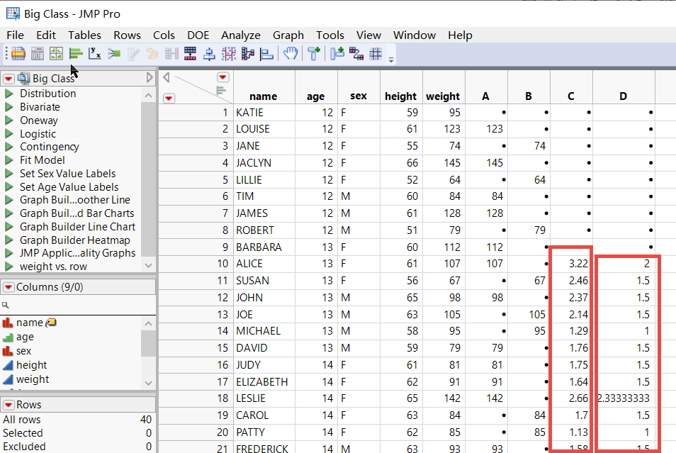

Can the calculations of these two steps be modified to be completed in one step?
Thanks Experts!
dt=Open("$SAMPLE_DATA/Big Class.jmp");
ca="A";If(Is Missing(Try(Column(ca)<<Get Name)),New Column(ca));Column(ca)<<Formula( if(height>=lag(height,1),weight) );Current Data Table()<<run formulas;Column(ca)<<deleteFormula;
ca="B";If(Is Missing(Try(Column(ca)<<Get Name)),New Column(ca));Column(ca)<<Formula( if(height<lag(height,1),weight) );Current Data Table()<<run formulas;Column(ca)<<deleteFormula;
ca="C";If(Is Missing(Try(Column(ca)<<Get Name)),New Column(ca));Column(ca)<<Formula( if(row()>9,round(sum(A[Index(Row()-9,Row())])/sum(B[Index(Row()-9,Row())]),2) ));Current Data Table()<<run formulas;Column(ca)<<deleteFormula;
ca="D";If(Is Missing(Try(Column(ca)<<Get Name)),New Column(ca));Column(ca)<<Formula(  if(row()>9,sum(weight[Index(Row()-9,Row())]&height[Index(Row()-9,Row())]>=height[Index(Row()-10,Row()-1)])/sum(weight[Index(Row()-9,Row())]&height[Index(Row()-9,Row())]<height[Index(Row()-10,Row()-1)])) );Current Data Table()<<run formulas;Column(ca)<<deleteFormula;

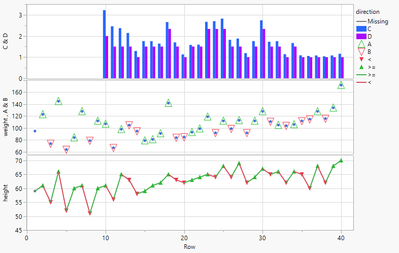

selection of A & B.
comparison of C&DD:
let's challenge it:
a)
weight[11] = 500;
b)
current data table()<< add rows(10);
height[41::50] = 70;
weight[41::50] = 1;
