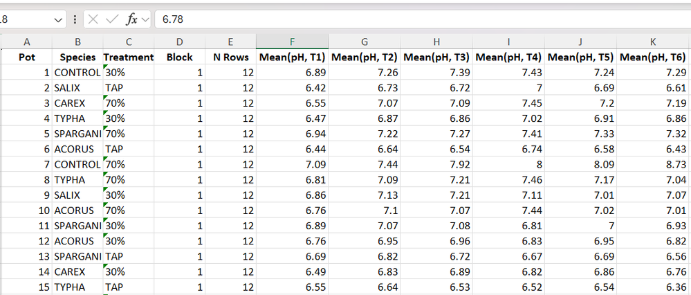

1. importing the excel sheet pictured below to JMP.

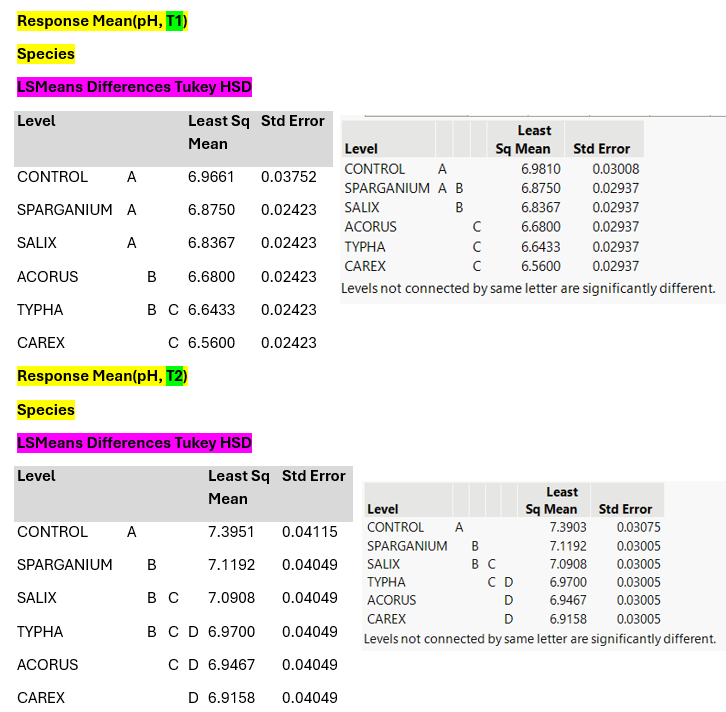

This is the part where I feel like something is wrong. We did this pH spreadsheet together, and I put the results into a word document pictured here with highlighted purple and yellow. The ones I did with the statistician guiding me are on the left, the ones I did by myself are on the right. As you can see, when I repeated it on my own to make sure I got the process right, the tukey test is slightly different... when I look at the "Least square mean," only the one on the Control is a different number. So I think that must be the key to it.
I haven't gotten much education on statistics except for a class I took 12 years ago in undergrad. I feel like I just understand it at a caveman level of "different letter in tukey test means we can count them as different." But I don't have a deep understanding of how this stuff really works.

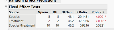

I feel like I must have missed a step or something, which is why my results are slightly different from his. Also according to my notes in the Fixed Effect Tests for the pH weeks only the "Species" category had a Prob > F that was significant (red) when we did it together, but when I tried it by myself just now Species AND Treatment are red... so I know something funny is going on.

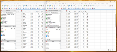

  As you are learning how to use JMP in your analysis, one thing I HIGHLY recommend is that whenever you perform any kind of analysis and you might not remember all the little steps, you can always got to the red-hot button (triangle) next to the top-most level analysis (e.g. Fit Y by X, or Multivariate) and select Save Script > To Data Table. You can then go back into that script and see what all the settings were that got you that analysis. It's extremely helpful and saves you time.
  Anyway, if you can share the data in an anonymized table (Menu: Tables > Anonymize), this could be a very good place to start so that others can try and repeat what you are getting. If you do anonymize it, it might be helpful to let the community know which columns to use for which variable, e.g. Y or X. You can keep the important details hidden, but we would still need to which columns need to be used where. Below is a screenshot of the Big Class.jmp sample data as original and as anonymized so you know what it does to the data table.

2. Based on one of your screenshots, it looks like you've put one column in as a Random Effect, is this true? You show a snippet of the report that reads "Fixed Effect Tests", which means one variable must be included as a Random Effect. Which one are you using? Is it Block? Or is the column you're using given a different Attribute, like Mixture Effect or Excluded Effect?
3. Was this a designed experiment?  Was it a DOE? If so, what model did you start out with in the DOE? This is an important starting point as well -- if it was really a DOE, which it kind of looks like because if you look at distributions of Species, Treatment, and Block, it does look like things are distributed across the different factors evenly.
4. I can reproduce your numbers in your screenshots where you compare your results with the others that you got with the stats professor, but I can't reproduce the left side of the screenshots. I'm guessing this is where something related to the random effects is coming in, but we don't know what's been used as a random effect.
5. Related to 2 and 4: I am not reproducing your DFDen values in your Fixed Effect report that you shared, and this is likely due to what you're defining as Random and the other model effects your defining. I am seeing that Species*Treatment is having a large Prob > F value and very low Logworth value, so it's likely not an important factor (at least for Mean(pH,T1) -- I haven't looked at other Mean(ph,T*) columns yet because I can't reproduce both instances that you're showing.

  As for your data, The only thing that I can come up with is there is a typo somewhere in the Treatment column for the CONTROL Species. If you look at the distributions of Species, Treatment and Block, there is one extra 30% treatment in Block 2 for CONTROL than in all the other blocks. Was that by design, or is that a typo? I've tried duplicating the Treatment column and changing either row 30 or 34 to the alternate value, but this still doesn't allow for me to reproduce your results that are on the left of your original post. I can perfectly reproduce the results shown on the right side of your post, though.
  Maybe go back to the original raw data and make sure there aren't any typos or mistakes that were analyzed incorrectly.
