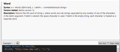

I guess I had the source of the problem defined incorrectly.  If I include ":" as a delimiter together with "_" I seem to be getting red ink and a failed formula.

If you need to specify multiple delimiters with the Word function, it's a single character string containing all the delimiters. For your example, you would specify ":_" as the third argument to Word.

Ah.. So you wish to have two strings to separate using Word? Add all the delimiters into the same string and it should work
Word(2, "A_B:C", "_:")
