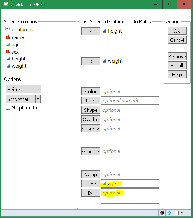

Craige_Hales
Re: Can I save each page of a graph(from graph builder) into one separate image file?
Also, using by groups is about the same as the page option, and will make for easier solutions with xpath. To see the launcher that lets you use a by group in place of page, red-triangle->redo->relaunch
Graph builder also has this traditional launcher dialog, mostly not needed.Graph builder also has this traditional launcher dialog, mostly not needed.

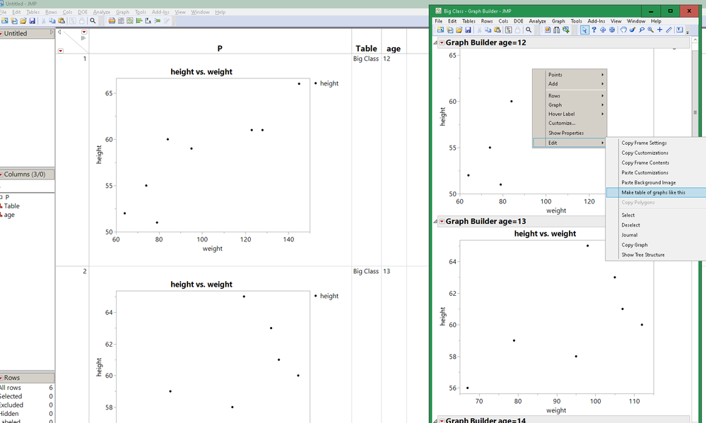

Craige_Hales
Also the by group version works with a data table to hold the graphs
The left-side data table was captured by the command on the right.The left-side data table was captured by the command on the right.
