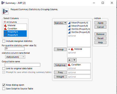

jthi
Re: Can I Create a Linked Summary Table?
I would suggest creating one Materials Database file which will have all the possible materials and their properties. Then you can use summary platform to get many of different statistics out of it and the data will be grouped properly.
I wouldn't most likely even save this Summary table because it is so easy to create when needed.
After you get more used to JMP and JSL you could create a script which users could use to get this summary table when ran (and if you have to have individual data tables you could concatenate them before creating the summary table).
Welcome to community and hopefully this gives some ideas!
-Jarmo
