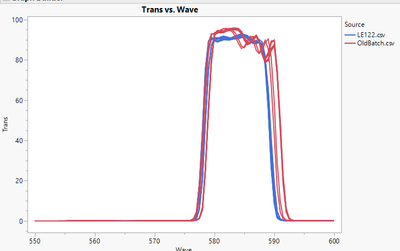

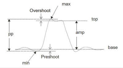

I would like to calculate the Top(not max) of an imperfect square wave signal that I measure, the distinction of the Top and Max is illustrated in the image below. It is somewhat the average of the high value right after the cliff at the edges of the signal.

Looks like you have multiple such curves in your data. And they don't have an exact profile as the one that you show.

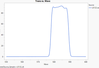

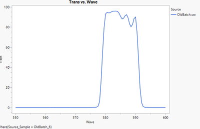

peng_liu_2-1640097448445.pngpeng_liu_2-1640097448445.pngpeng_liu_3-1640097474070.pngpeng_liu_3-1640097474070.png
So questions:
  1. What is the definition of "Top" given the real data?
  2. Do you want the all Top's of individual curves or, a "Top" of all curves? Definition.

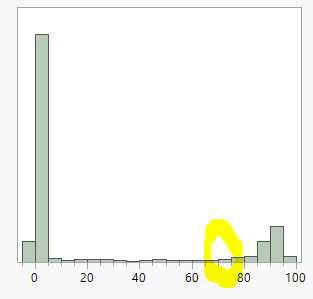

Second one. If the desire is just a rough quantity of some sort of "bottom" at the "top", seems even a histogram can be an interesting approach.
