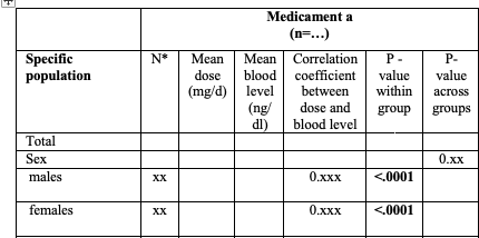

I am being honest with you, I cannot really say neither. As I said I am mostly working according to what my PI instructs me to do. But I can post a screenshot of the table I was asked to work on. Bildschirmfoto 2021-10-20 um 10.48.30.png
Basically I use a multivariate analysis to calculate the correlation coefficient and p-value within group via Spearmans. And the question is how to calculate "mean dose" and "mean blood level".

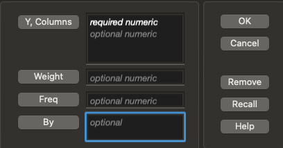

Y --> 1) med level 2) med dose
By --> a) list of meds b) e.g. sex

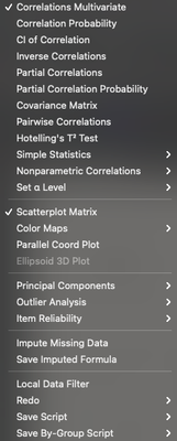

and I was looking for a way to find a median here in the list of commands. Since you can access the mean value via "simple statistics"

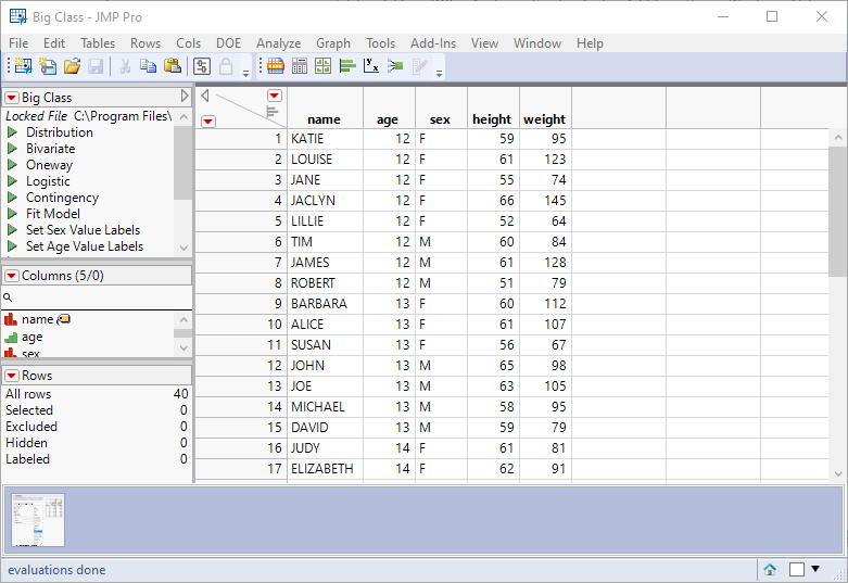

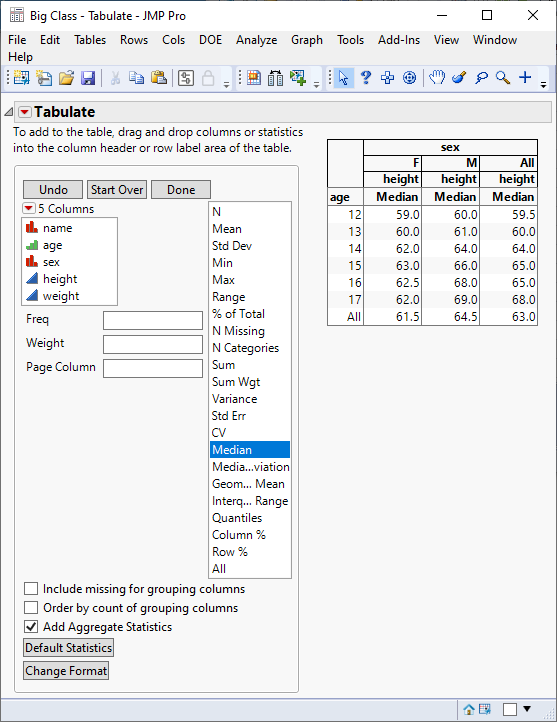

As for the median levels, the Tabulate platform is a versatile summary tool. Select Analyze > Tabulate to start. It is a drag and drop tool. Variables are used to group data or to analyze. I opened the Big Class data table in the Sample Data folder to use height and weight instead of your actual Dose and Blood Level variables. I used age and sex as grouping variables. Here is the data table:
Here is the result in Tabulate:
You can learn how to use Tabulate in this chapter from the JMP Help. I hope that this reply helps with your remaining questions!

Thank you! Though one question, maybe I missed out that part: Where can I find the overall median for dose and level (for each male and female as a whole) in this interface?
Re: Calculating median when comparing two continuous variables in a multivariate analysis
Select the Add Aggregate Statistics option near the bottom on the left side:
