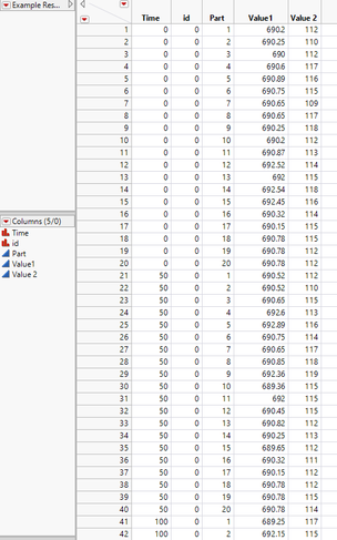

Hi everyone!
I have attached a example file under this post.
I'm currently trying to calculate the percentage of difference,
which is given by (New Value- Original Value)/Original Value
In this case, Time 0 is taken as the reference ( Original Value).
 For example:
Time: 0, Part: 1 Value 1: 690.2
Time: 50, Part:1, Value1: 690.52
(690.52-690.2)/(690.2) = 0.046%
Time: 100, Part:1, Value1:689.25
(689.25-690.2)/(690.2)= -0.13%
The result I'm suppose to get is to have a new table with the Time, id, Part unchanged,
while having the new values of Value 1 and Value 2 in percentage format.
I have thought of moving the Different Time values into different tables,
then compute it against the Time 0 and append it to a new table, but I have no clue on
how to write it on script.
I have written some script in the "Percentage Different Progress" file, but I'm stuck.
I really appreciate it if anyone could help me in this.
Thank you so so much in advance.
