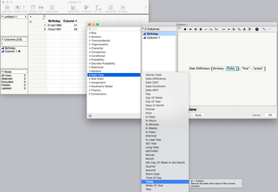

Hello,
I readed "JMP 15 documentation helps" but not found the answer, in addition of multiple searchs on the forum community.
I know it's easy : how calculate the age with the date of birthday ?
I tried : "DifferenceDate(DateBirthday, "Today", "Year")"
Thank you to take one minute for a beginner.
Jeff_Perkinson
Re: Calcul age from date of birthday
You need to use the Today() function.
Date Difference( :Birthday, Today(), "Year", "actual" )
Notice I've also added the "Actual" alignment argument to Date Difference() to get age as we usually think of it.
-Jeff

Jeff_Perkinson
-Jeff
Perfect. Thank you.
