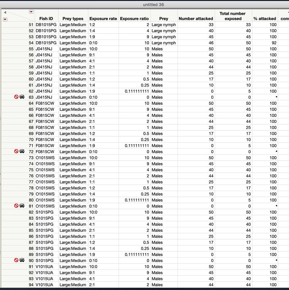

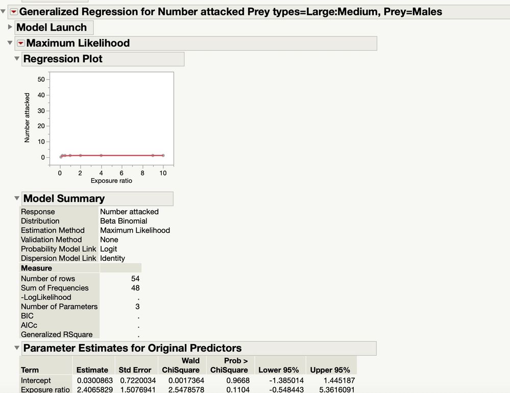

I'm fitting a beta binomial generalized regression but the regression plot in the output is not accurate.   The number of success (or number attacked) should be between 0 and 50 but in the plot is never above 5. Attached is a screenshot of the data and output.  Any ideas what is going on here?Generalized regression beta binomial output.jpg
