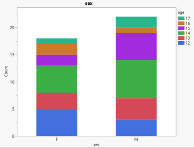

Why is the value order of a stacked bar chart opposite to the value order of the legend?

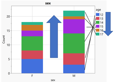

Seems that this is the explanation why the Graph looks like this ...
I still believe that no user wants to have the order in the graph and the legend go in opposite directions.
At least nobody in the audience.

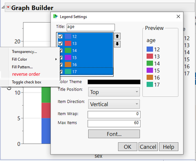

I just detected a wish from 2021 asking for a one-click solution for this problem:
Reverse order button in legend settings
e.g. something like this:

I think this is from history. Traditionally bars are built from the bottom-up, like stacking blocks on top of each other. Hence the name STACKED bar chart. However, when reading a legend, we read from the top down, so the first item placed goes at the bottom of the bar, but at the top of the list. You can edit the order of the items in the legend by double-clicking it and using the arrow buttons to move items.

yes, definitely, with the aligned order the information will be much easier to understand.
@XanGregg could add a section about legens to his talk:
Plenary: All Graphs Are Wrong, but Some Are Useful - Xan Gregg
You can create graphs (legends) that the eye can analyze without the brain - and you can create graphs (legends) where there is a clear threshold as to who will understand the graph correctly ;)

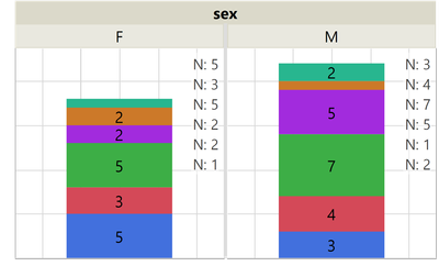

For the Caption Box, is there an option to put the numbers in the "right" order?
Alternatively:
Is there a setting to use the colors of the plot also for the caption to give the audience a chance to get it right :)
Open( "$SAMPLE_DATA/Big Class.jmp" );
Graph Builder(
	Variables( Group X( :sex ), Overlay( :age ) ),
	Elements(
		Bar( Legend( 3 ), Bar Style( "Stacked" ), Label( "Label by Value" ) ),
		Caption Box( )
