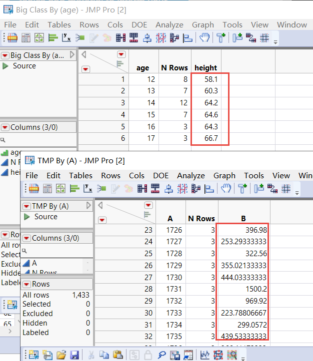

Averaging with the Summary command. How can I use the mean column of the generated table to keep a significant number?
I have seen Big Class.jmp's table with the same JSL get a mean column that already retains a significant number, but my own table does not.

  • I saw that the summary table generated by Big Class.jmp was automatically formatted.

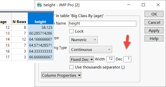

Is your desire to have the actual value in the data table to only have a specified number of significant digits or is the requirement to just have the format for the result column to have the specified number of digits?
By default, when the Summary table is generated for a column that has the number of decimal places specified in it's format, JMP will add an additional decimal place to the output tables summarized column.  To set the format's number of significant decimals to anything other than this will require the adding of JSL to set the format.

I want the actual value in the data table to only have a specified number of significant digits.

  • This script gets larger volume.
Column( d2, 3 ) << Format( "Fixed Dec", 20, 2 );
  • Do have to use this script?

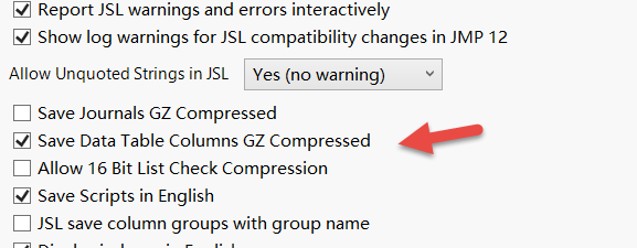

There are several ways to compress your data.  If you want to compress specific columns, you can select them and then go to
     Cols=>Utilities=>Compress Selected Columns
The preferences can be set  to save the tables in a compressed format.  There is also a preference that will allow for propagate compressed columns.
Look in the General preferences.

  • My data sheets are all compressed.
