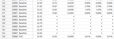

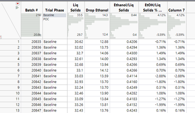

I'm working with JMP 17.0.0 - I'm trying to find a way to calculate the % Change between two conditions in a column that will update automatically as new data is added.  See the attached data file for reference.
Presently to find this, I make a Tabulate table where I will use the Trial Phase column in the column zone and drop the calculated yield per batch (Ethanol/Liq Solids) into the drop zone for rows.  Then using the average yield for Baseline from this table, I then make a new column where I calculate:
[:"Ethanol/Liq Solids" - ("Baseline" average ethanol/liq solids from Tabulate)] / ("Baseline" average ethanol/liq solids from Tabulate again)
I change the column properties to percent with two decimals, and this gives me exactly what I need (as shown in the data table).  But the trouble is that if I add more baseline data, then I need to pull up the Tabulate again and find the new baseline average, then update the formula column to correct it.  Is there a way to set JMP to update this baseline average automatically so I don't need to update it every time?  The automation would also be useful in the situation where I might need to exclude some "baseline" data for one reason or another and have the % change update with that as well.

Hi Jim, unfortunately that would average the Baseline along with the POC condition (which is only in one row - the very last one).  I need to segregate the average of just the baseline from the POC and other future trial phases.

Do you know of anything I can add to the formula that would recalculate in the event that some Baseline rows are excluded?
jthi
Re: Automatic Calculation of % Yield Change
You can add Excluded() as byvar and excluded rows will have their own values calculated but won't affect the non-excluded rows
(:"Ethanol/Liq Solids"n - Col Mean(If(:Trial Phase == "Baseline", :"Ethanol/Liq Solids"n, .), Excluded()))
 / Col Mean(If(:Trial Phase == "Baseline", :"Ethanol/Liq Solids"n, .), Excluded())
