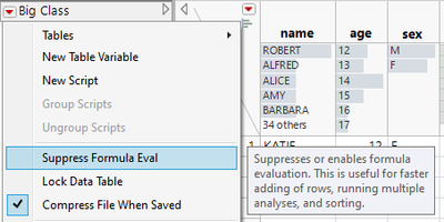

If you are talking about just formulas make sure that the formula evaluations haven't been suppressed from data table

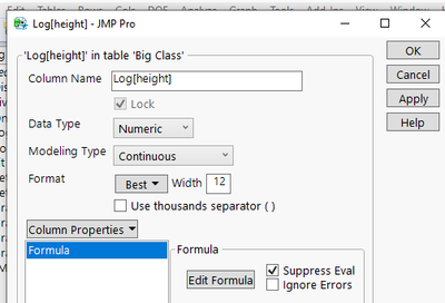

or from the formula (from column panel grey + indicates suppression on formula)

Thank you!  The formula eval was suppressed.  It must have changed with the jmp 17 install.
