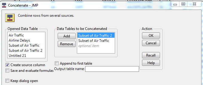

uday_guntupalli
Level VIII
Re: Analyzing two files together
@shorwitz :
       I dont see the sample files - but the answer to your quesion would be the following :
dt1<< Concatenate(dt2,
	                        Create source column
// Create Source Column - will provide a new column that helps you identify which table the data came from .
      You can acheive the same interactively by going to  Tables ==> Concatenate .
       Example below.
Uday
Best
Uday

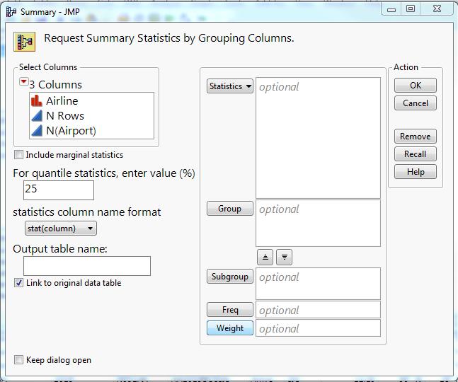

uday_guntupalli
Level VIII
@shorwitz :
          Here is an example to do something similar. Alternatively ,
  Tables ==> Summary
Data Table( "Air Traffic" ) << Summary(
	Group( :Airline ),
	N( :Airport ),
	Freq( "None" ),
	Weight( "None" )
Uday
Best
Uday
