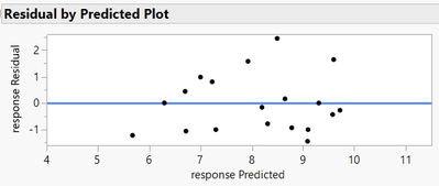

In your model "reduced model from original script", there doesn't seem to be a pattern in the residuals :

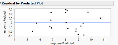

However, in your more simple model, the residuals look a little more suspicious, with some trend and possible curvature for possitive residuals values :
