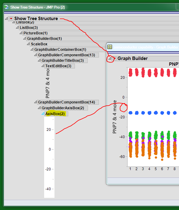

Craige_Hales
Re: Adjusting variables on Graph builder automatically
After Jim's script, you can further control the axes like this
outline = report(gbfc);
yaxis = outline[axisbox(2)];
yaxis<<min(-100);
yaxis<<max(60);
I use the outline's gray open/close triangle->right-click->Edit->ShowTreeStructure to discover axisbox 2 is the Y axis:
Pick ShowTree Structure from the outline. Then click part of the report to find it.Pick ShowTree Structure from the outline. Then click part of the report to find it.

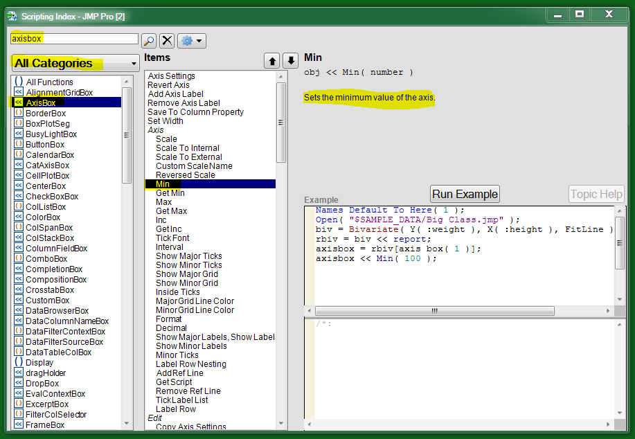

Then I use the scripting index to look up AxisBox
Using the scripting index to find messages for an AxisBoxUsing the scripting index to find messages for an AxisBox
