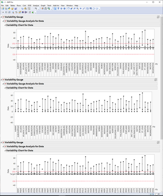

Example

nw = New Window("",
	vlb = V List Box()
For Each Row(dt_limits,
	lowlimit = :LSL;
	highlimit = :USL;
	targetlimit = :Target;
	If(Is Missing(targetlimit),
		vlb << Append(dt_stack << Variability Chart(Y(:Data), Model("Main Effect"), X(:city)))
		vlb << Append(Eval(EvalExpr(
				Y(:Data),
				X(:city),
				SendToReport(
					Dispatch(
						{"Variability Gauge Analysis for Data", "Variability Chart for Data"},
						"2", ScaleBox,
						{Add Ref Line(Expr(lowlimit), "Dotted", "Red", "LSL", 2),
						Add Ref Line(Expr(targetlimit), "Solid", "Black", "Target", 2),
						Add Ref Line(Expr(highlimit), "Dotted", "Red", "USL", 2)}
Write();
-Jarmo
