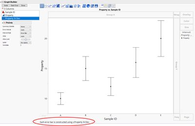

Hi guys, I have a simple problem which I have been unable to solve. I have a dataset which I would like to plot in a Fit Y by X style scatterplot against another dataset. For each datapoint I know the standard deviation and I would like to add these standard deviations as error bars to the plot, is there anyway to do this?
It seems like JMP only does this normally if it has calculated the standard deviation itself, I don't want this as I already know the standard deviation for each and every datapoint.
Thanks for any help
11 REPLIES 11
Re: Adding error bars in JMP
There is an 'Interval' feature that allows you to add the error bars (i.e., with a column containing the standard deviations for each row/sample):
For example
