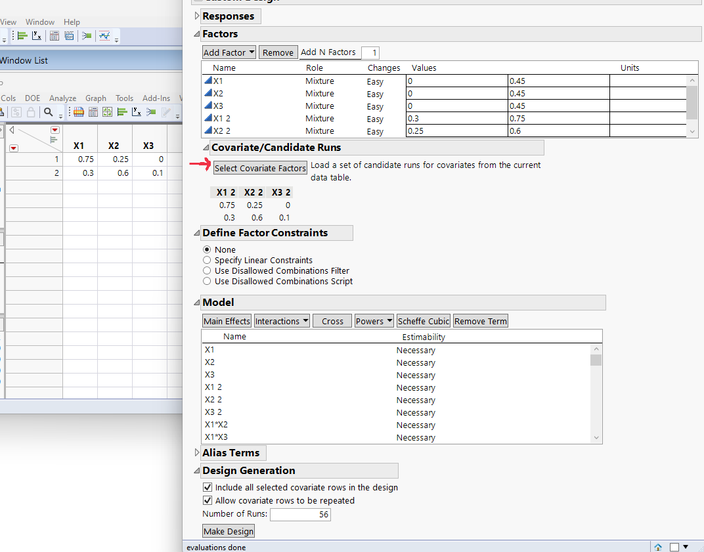

Yes. If you make a separate table with your 4 candidate runs, then use the 'Select Covariate Factors' button, these candidate runs will be considered/included (depending on the check boxes at the bottom) in your design.

Thank you  @Jed_Campbell . So my question is, Why does JMP treat them as different factors?. As far as i understand, by candidate runs we mean to add some custom values of the factors that we would like to see as part of the design. Please correct me if i am wrong . And in my case they were treated as only covariate factors and not mixture factors. Hope my question is clear for you.
thanks in advance.

Some additional information about the option proposed earlier :
The candidate set approach, described by @Jed_Campbell, may be useful if you have a lot of data points fully covering your (constrained) experimental space. If you start from 4 points only and follow the option above, you might end up with an error or small design not very adequate for your objective(s).

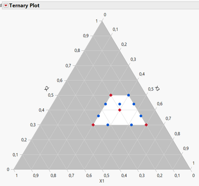

Example here with 4 initial runs (red) augmented in a Scheffe Cubic design with 8 additional runs (in blue) :
You can have a look at both approaches with the toy dataset I have created with 4 initial runs, and see what looks best for you in your use case.
