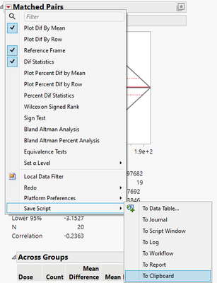

jthi
Re: Adding a Format during creating of a Matched Pair
Modify the axis in the report, go to red triangle and copy the script. It should be same (or very close) to what you would get if you moved that part inside the Matched Pairs() message
Matched Pairs(
	X(:Dose),
	Y(:BP 8M, :BP 8W),
	Reference Frame(1),
	SendToReport(
		Dispatch({"Difference: BP 8W-BP 8M"}, "1", ScaleBox,
			{Format("Scientific", 12)}
As you are using By it might require some extra modifications
-Jarmo
