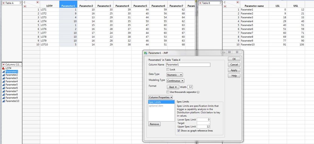

I've two tables:
One include many columns (parameter1, parameter2...) and one include all the parameters with lower spec and upper spec (parameter name, LSL,USL)
How can I add to the first table for each parameter the specs directly to the properties?
Thanks in advance!

There is an JMP Addin that does exactly what you want:
Write Limits to a Data Table from a Limits Table

Fixed
Thanks a lot!!!
