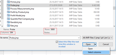

Accessing .jmp file row/col count and notes without opening file
This information can be accessed through JMP Open file at least on Windows:
Wondering if it possible to access these through scripting without opening JMP datatable (Open Data File Options )?
Column names can be accessed with

The way JMP shows it in Open Data File menu is way faster (maybe...). I have some tables which are quite wide, 60columns, and very tall, ~15million rows. Opening these is fairly slow. I can get column count by opening it only as column names and maybe row count by opening datatable only as single column but all rows, but I think this will still be slower. Of course it could be possible that JMP is doing something like this behind the scenes?
