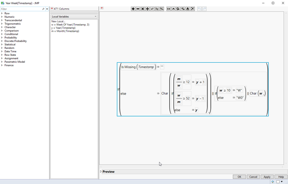

Hello,
is there a simple way of getting the jsl code of a generated column (I used New Formula Column from column menu) as I am wondering how to deal with the local variables in the New Column jsl code (Formula).
Best regards
2019-02-26 10_06_23-Year Week[Timestamp] - JMP.png2019-02-26 10_06_23-Year Week[Timestamp] - JMP.png

Re: Access jsl code of New Column with Formula
NamesDefaultToHere(1);
// Add a formula column . . .
nc = dt << NewColumn("BMI", Numeric, Continuous, Formula((:weight/:height^2)*703));
// Get the formula expression from a column into a variable . . .
bmiFormula = nc << getFormula;
Print(bmiFormula);
Thank you very much - works perfect
