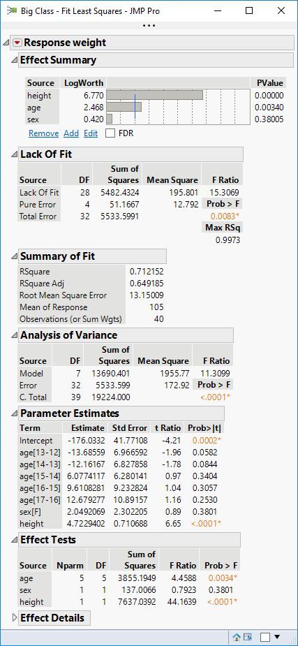

Also, the estimation procedure differs. The least squares solution is a closed form that is computed directly. The GLM solution is an iterative method for maximum likelihood estimates. Here is the same model estimated first with Fit Least Squares platform:

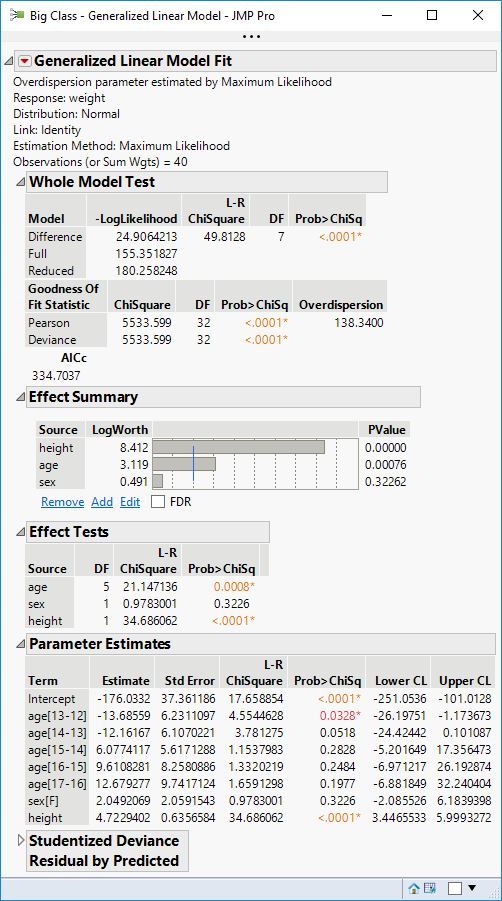

Here is the same model estimated with GLM using the normal distribution for the response with the identity link:
The parameterization is the same for the categorical predicts age and sex but the estimation routines differ. The former is based on sums of squares with t and F tests, and the latter is based on likelihood with chi square ratio tests.

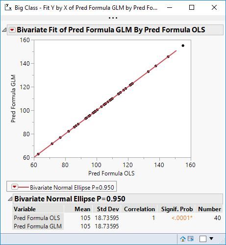

The two models produce identical predictions of the response:

With regard to point 3, OLS is solving the normal equations directly. The results are based on sums of squares. This leads to the F test for the whole model. The normally distributed parameter estimates leads to t tests. On the other hand, the GLM is using MLE. The results are based on -2LogLikelihood. This leads to chi square tests (likelihood ratio tests).
So the estimation and tests use different methods. They are not expected to give identical p-values. Note that these values generally agree if not exactly.
