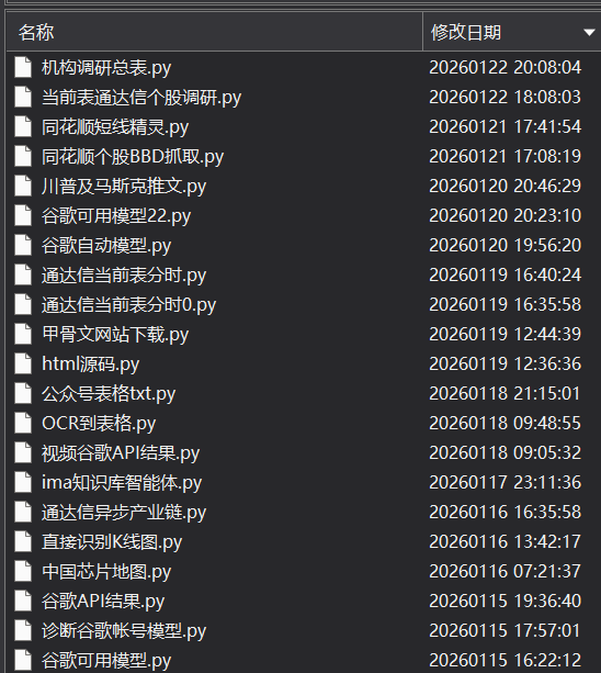

lala
Level IX
回复: AI + JSL
All my current python is written with gemini3 pro.Interact directly with JSL.It was basically correct in one go.All are output to the JMP table

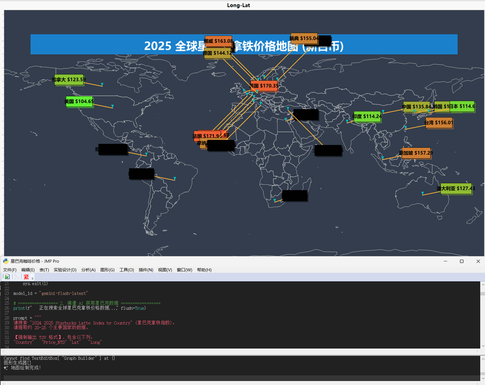

lala
Level IX
回复: AI + JSL
This effect can be achieved the first time.The second fine-tuning was perfect.

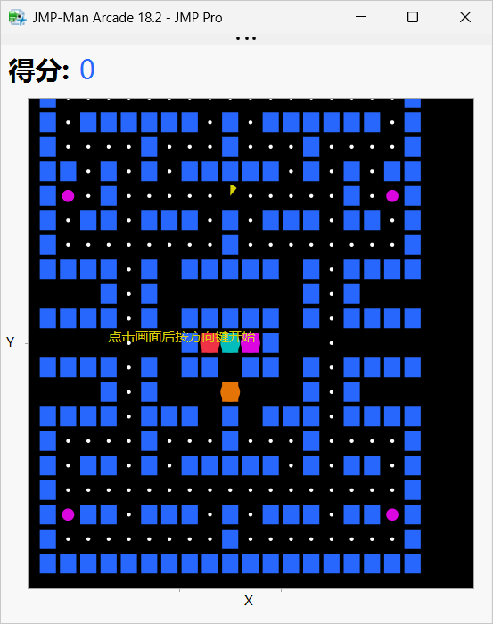

lala
Level IX
Re: AI + JSL
gemini3 pro watched the video of this post.It claims that its effect must be better and faster2026-01-24_07-49-55.png
