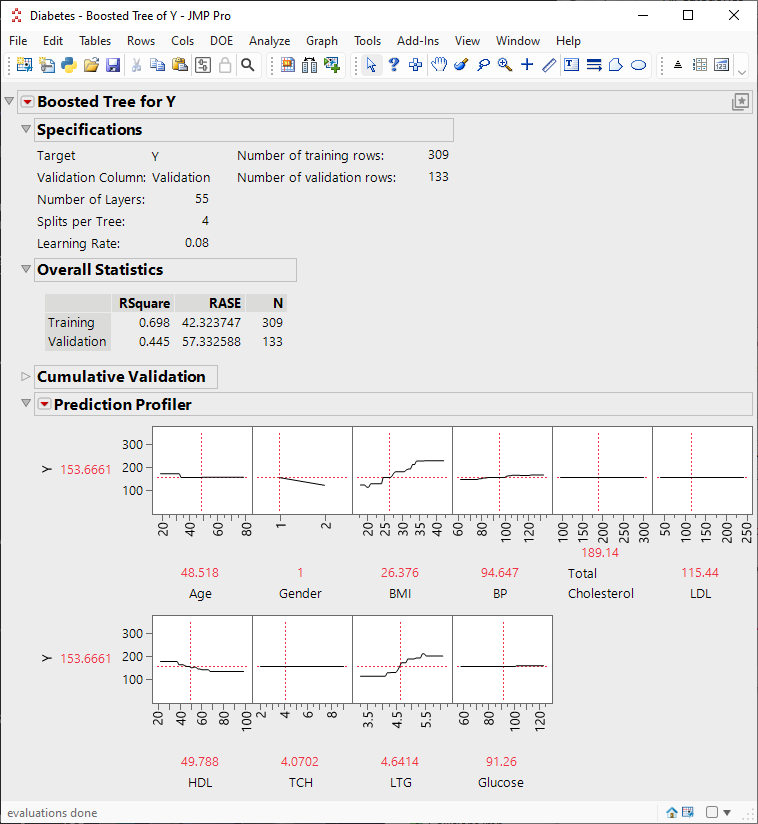

I am involved w/ a script where I fit Boosted Trees , store to a report. During the run, I also create a summary table for all fit metrics.
Problem: when the JRP is re-opened from storage, it reperforms BT which is an issue.
Is there a way to store a JRP where the re-fit ability is disabled , and would simply store last fit model . I want the report to show me the unique state of fit.

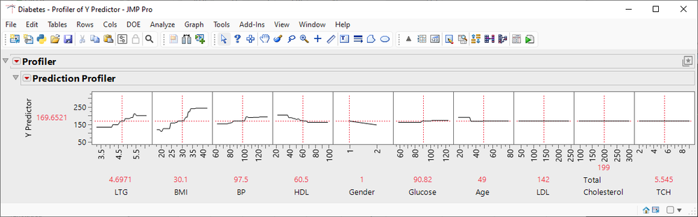

If you just need the profiler, you don't need to have the platform as you can just use the formula: Graph > Profiler and add your prediction formula.

Thanks for the quick response. This will work for my case. I wasn't aware of the profiler being available this way.
