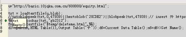

lala
Level IX
Re: 请教专家:怎样解决下载这个网站数据的乱码问题?
感谢专家的帮助!
这个网站是不需要登录的免费网站。
我将它的"网页源代码"截图

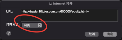

实际上,Craige_Hales已经给出了答案,在他的基础上,稍作修改如下即可。
Actually, Craige_Hales has already worked it out. The followed code based on his work.
u="http://basic.10jqka.com.cn/600000/equity.html";
blobdata = loadtextfile(u,blob);
chardata = blobtochar(blobdata,"gb2312");
filename = savetextfile("$temp/deleteme.html",chardata);
d1=Open(filename,HTML Table(3));
此外,你也可以在导入时选择从internet导入,打开方式选网页,然后选择需要导出的数据表,也能正常显示。
Besides,Selecting File > Internet Open > Web Page could do this too, just set Open As to Web Page instead of Data.
