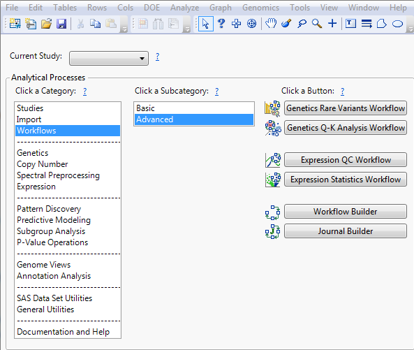

GWAS analyses have long been supported in JMP-Genomics.  Easy to follow work flows are available for Q-K Analysis, or GWAS accounting for population structure and kinship.
Figure 1: Q-K Mixed Model Workflow

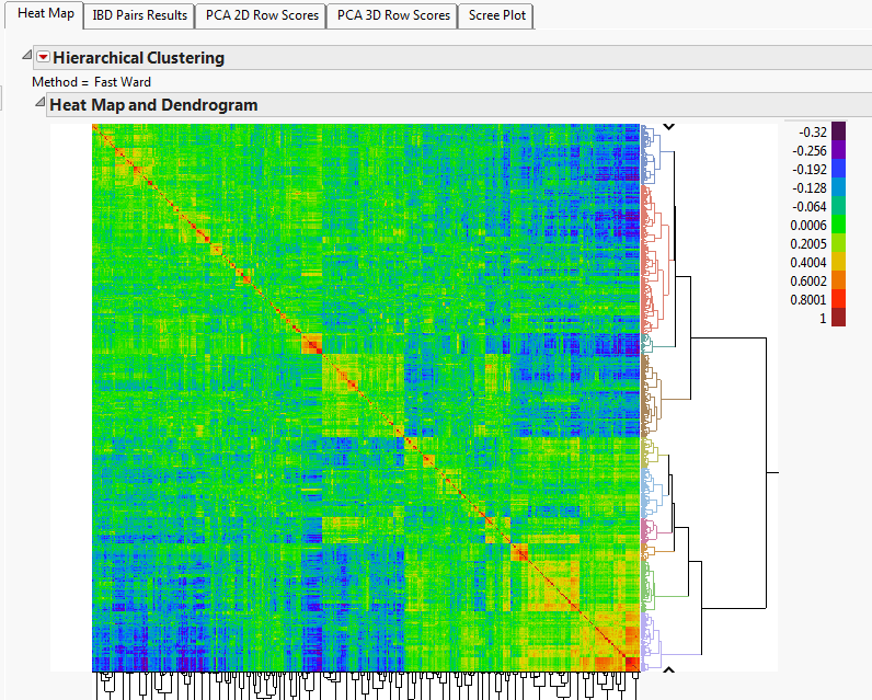

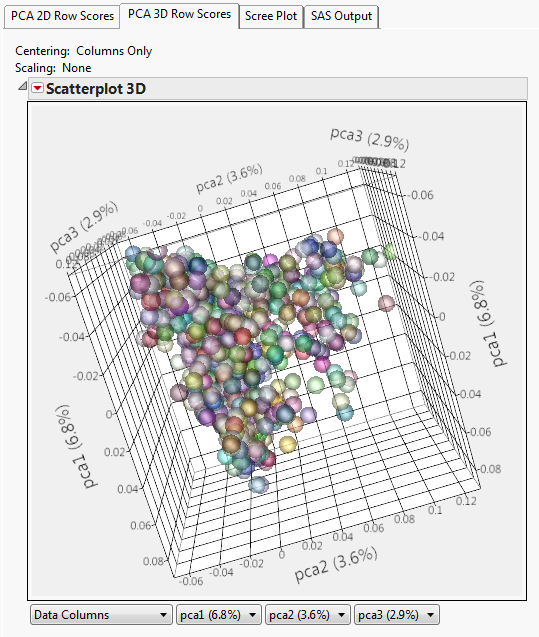

First Q and K matrices were solved within the data for each year:
Figure 2: Q-Matrix Population Structure PCA
Figure 3: K-Matrix Cryptic Relationship Heat Map

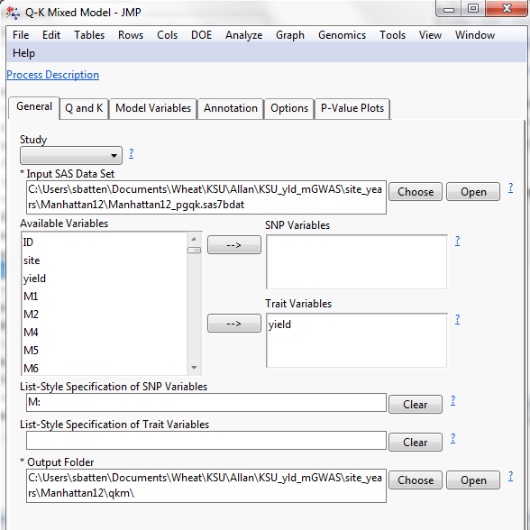

Next the Q-K Mixed Model was solved within each year with application of FDR multiple testing correction:
Figure 4: Q-K Mixed-Model

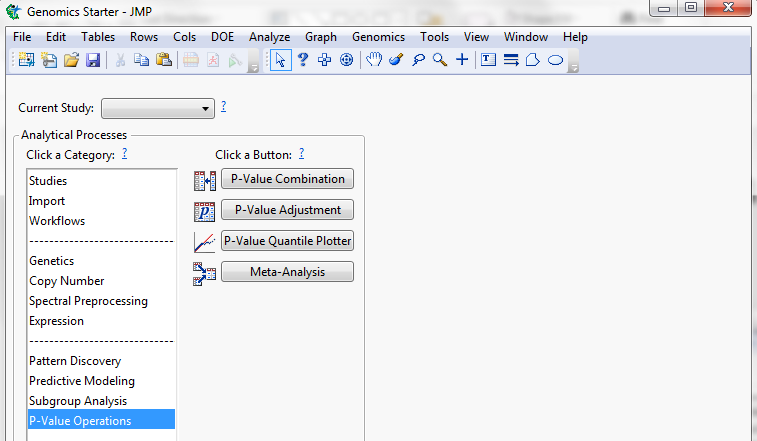

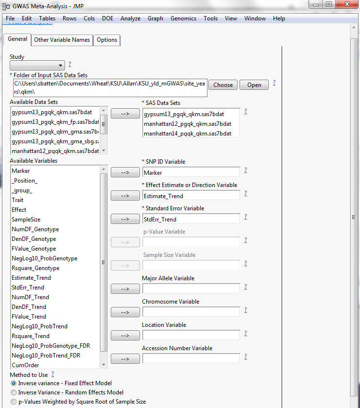

Now a meta-GWAS can be applied over all site years by running a GWAS Meta-Analysis inputting all (_qkm) files derived from individual Q-K Mixed Models.  We used the inverse-variance, fixed effect model with FDR multiple testing correction option, resulting in an estimate and standard error for each marker studied, since effect of the marker was the desired outcome.
Figure 5: GWAS Meta-Analysis

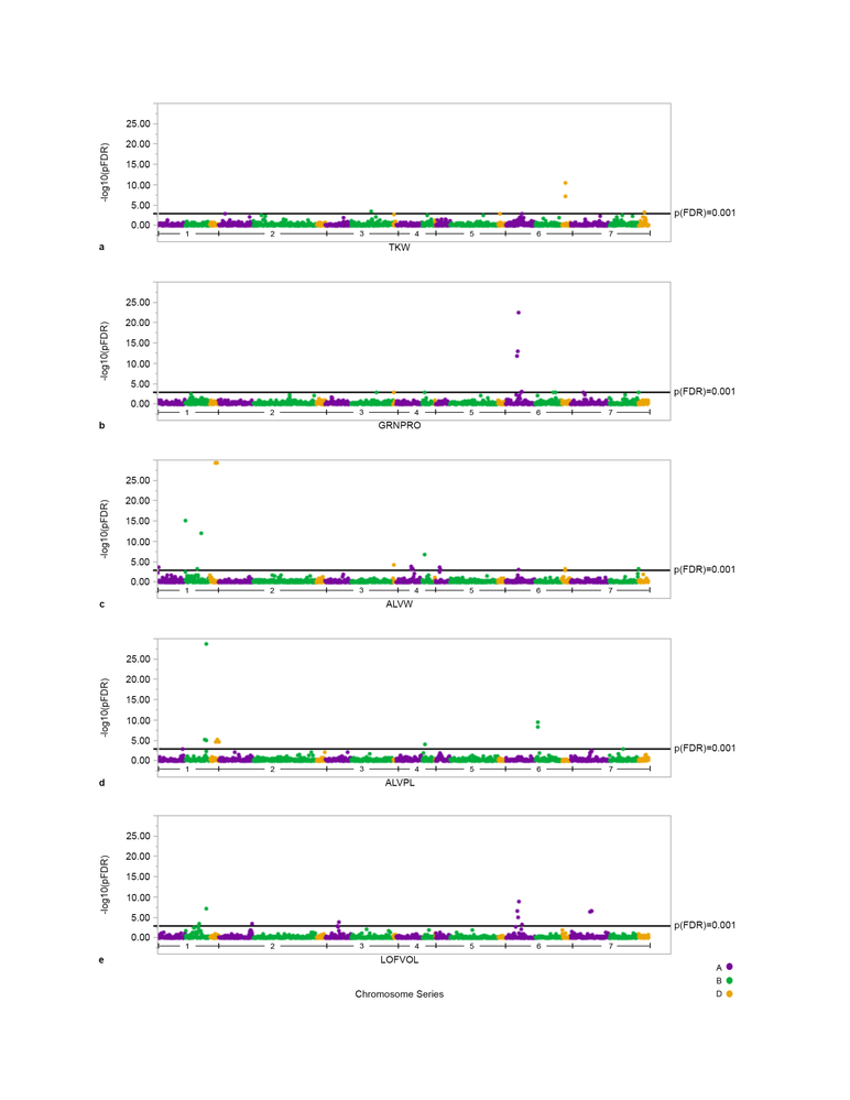

Resulting in output of significant meta-QTL for wheat processing and end-use quality traits.
Figure 6: Manhattan Plots of significant meta marker trait analyses for several quality traits

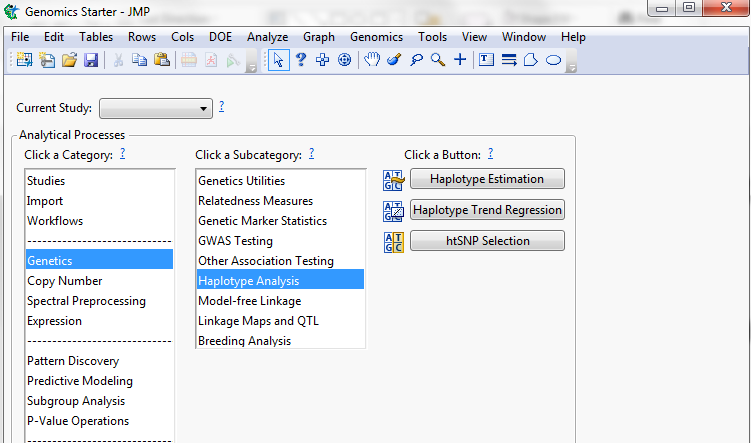

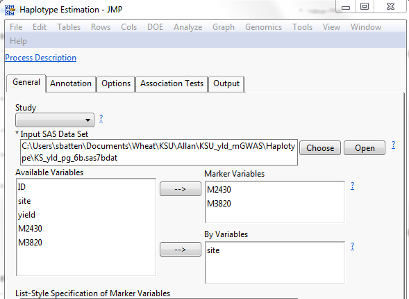

Digging deeper, we wanted to know the effect of the QTL, rather than single SNPs, so the next step was to determine the effect of significant haplotypes.  Note, haplotypes could be determined before mapping, and used as the unit of mapping, but wheat has a LARGE, not fully referenced genome, and this haplotype GWAS was not feasible at the time.
So, we reduced the genotype file to only the significant markers that were in similar regions and estimated the haplotypes by region and year.
Figure 7: Haplotype Estimation path
Figure 8: Haplotype Analysis setup

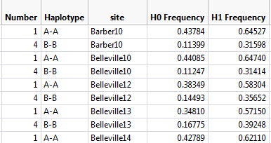

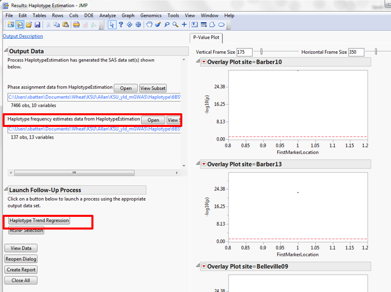

In the Haplotype Trend Regression Results, open the haplotype frequency estimates (_hfr) files.  Look for clearly differentiated haplotypes which make up 90% of the material (the remainder could be errors in genotyping or very rare haplotypes).  Take note of the haplotype number and allele calls for future reference.
Figure 9: Haplotype analysis results window
Figure 10: File needed (_hfr) that will be added on for meta-haplotype analysis

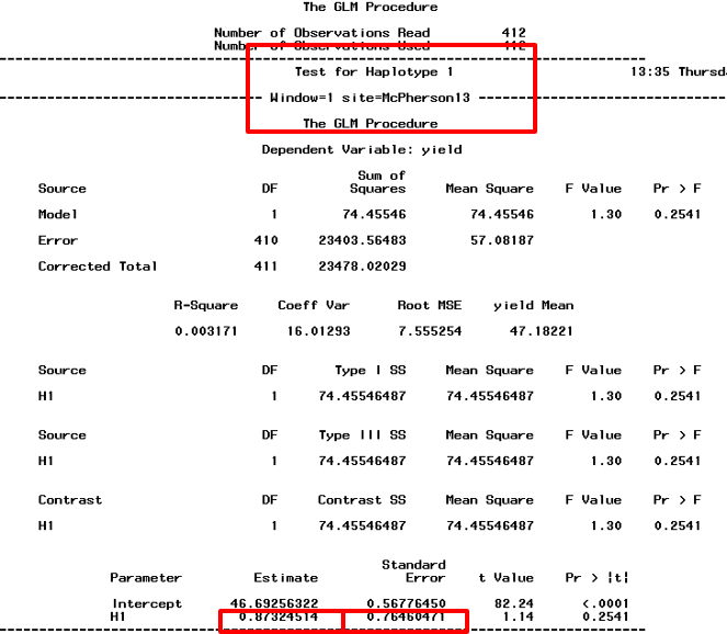

Then launch haplotype trend regression, which results in SAS output.  Look for the haplotype number within the given site or year and append estimate and standard error in the (_hfr) file.  Save file with new name for meta-analysis of the significant haplotypes.
Figure 11: SAS output file of haplotype trend regression
