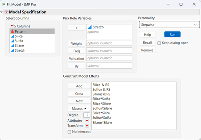

  1. Go to Fit Model platform (or click on the script Model in the DoE table), specify the response(s) and terms in the assumed model (if these  panels are not already pre-filled) and choose the Personality Stepwise. Click on Run.

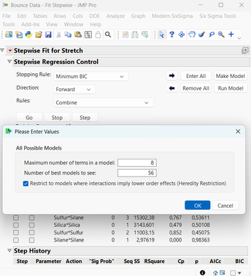

  2. Go to the red triangle next to Stepwise Fit, select All Possible Models, and define the maximum number of possible terms in the models as well as number of best models to see. Check the option Restrict to models where interactions imply lower order effects (Heredity Restriction). Click OK.

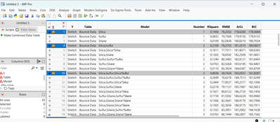

  3. Once the calculations are done, a new table All Possible Models appears in the report. RIght-click on this table, and choose the option Make Combined Data Table. You then have a new table opened with the results from the Stepwise platform:

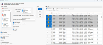

  6. Click on menu Table > Stack. Select all the new indicator columns and click on Stack Columns. You can rename the Label column as "Terms" and the Data column as "Presence". Click OK.

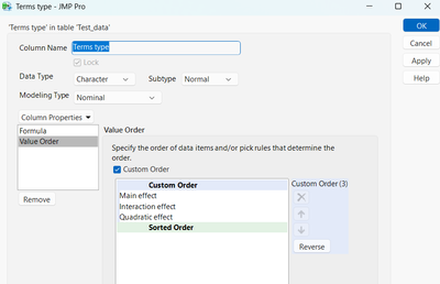

  8. Add a Value Order column property to the Terms type column, so that the terms in the model appear with the main effects first, then interaction effects, then quadratic effects:

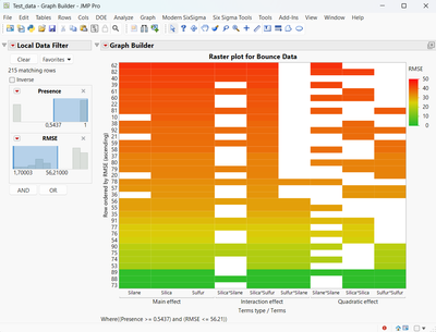

  9. You can then use Graph Builder and create the Raster plot !
    1. Use "Row" (or Model ID column) as Y variable.
    2. Use "Terms" as X variable.
    3. Add "Terms type" as a nesting X variable (in the location below X).
    4. Change the graph style to "Heatmap".
    5. Use one of the model's performance metric (for example RMSE) as Color variable and choose an appropriate color theme (like green to red).
    6. Right-click on the Y variable, choose Order by, and select your performance metric (ascending for AICc, BIC and RMSE, descending for Rsquare).
    7. Add a Local Data Filter on the column "Presence" and select only value different from 0 (1: term is present in the model).
    8. You can also add a filter on the number of models displayed by filtering/reducing the range of values for the performance metric.
    9. Once everything is set, click on Done. The Raster plot is ready !
