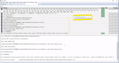

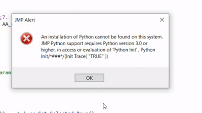

I have a script that executes a Python script (via Python Submit File) and initializes the Python interface using Python Init(Init Trace("TRUE")).
The script works fine on my computer but it fails when my colleague tried to run it.
I'm using JMP Pro 16.2.0 and his version is JMP Standard 16.0.0.
Based on the log and the error message, could you point me towards a solution or explain to me the likely cause of this error ?
I list below what we did so far:
  • Added conda.exe and conda.bat paths to the Path user environment variable. They are accessible from the Cmd Prompt.
  • Added JMP_PYTHON_MODULE_PATH and JMP_LIB_PYTHON_PATH as user env. variables.
Thanks for your help.
