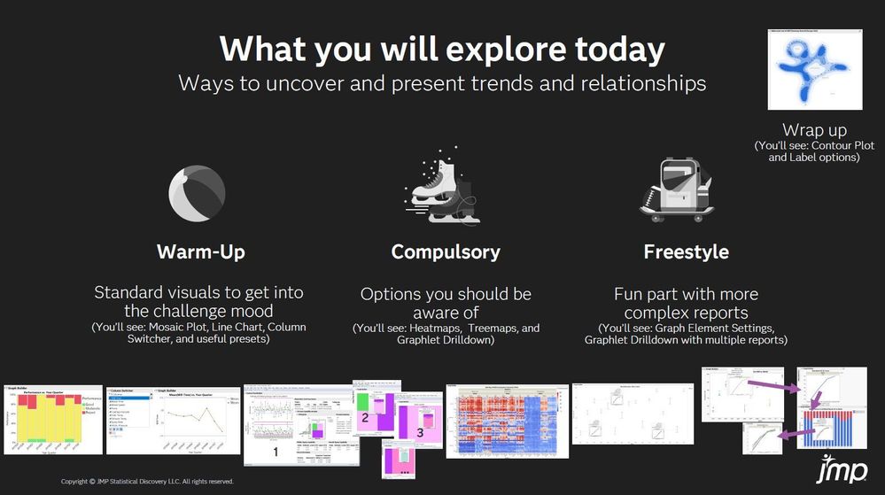

Welcome to this presentation about Graph Builder, it's called 30 Second Challenge. I love challenges. My wife always asks me why I'm doing challenges when there's no need for. Maybe it's come because I play table tennis in tournaments and so forth, and I'm not doing that anymore, so I need other challenges to get this adrenaline.
But the goal of today is really to show you some options, how you can make really fast, easy graphs or also some complicated graphs with the goal to get some insights, what is possible and what you could do. When we look at the outline, it's really about we want to show ways to uncover and present trends in relationships. That's all why we use visualization tools and want to uncover things in the data.
Throughout the course of this session, we really want to go, like in sports, we do a short warm up to get our muscles in mood and get in the challenge mood as well. Then we go to the compulsory where we show some of the options you should be aware of, also some other graph elements and the Graphlet drill down for sure.
The freestyle is really the fun part where I want to highlight that it's not difficult to show even complex reports or drill down with more than just one report. Finally, I will wrap up the whole thing to make discovery for you most valuable. So that's the introduction, basically.
Let's start with the warm-up. We are ready to really take a look into some easy things. How I will go through that, as always, I show you the result, I show you how you get there, and then I do the challenge for myself to beat the 30 seconds, basically. In the freestyle, we may need some of the seconds I save in the first warm up to extend the 30 seconds to maybe 45 to 60 seconds. Let's just start away. By the way, the material is all on the community and with all the steps included, so you can get aware of that.
