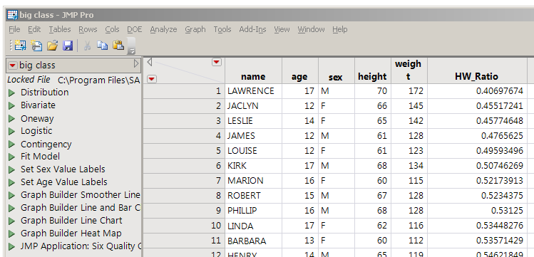

The formula column loop is done internally in JMP. When you create a formula column in a data table, JMP evaluates the formula for each row. Later, when you change a value in another column that the formula depends on, JMP will re-evaluate rows that depend on the changed value. JMP does these evaluations during idle time. If you want JMP to do them sooner and faster, send the data table a <<RunFormulas message.
dt = Open( "$sample_data/big class.jmp" );
hw = dt << New Column( "HW_Ratio", formula( height / weight ) );
dt << RunFormulas; // all 40 values are computed
dt << Sort(by (HW_Ratio), replaceTable); // tall enough for my weight?
Table with formula columnTable with formula column

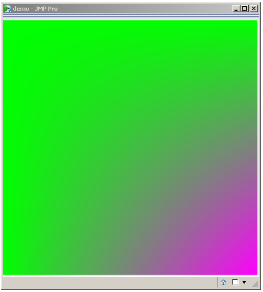

The parallel assign function uses multiple threads to fill in an array. Unlike the J function 3rd argument, you can't depend on any particular ordering of the elements being calculated. Parallel assign tries to keep threads isolated from each other and really doesn't want its expression accessing global data.
bigMat = J( 500, 500, . );
// these are global x and y values that are only copied into each thread, below.
x = 2;
yy = 3;
// x=x and y=yy is copying global values to local values of the same/similar name.
// bigMat[rr, cc] determines the array that is being filled in and the
// row and column names you'll use in the expression after the =.
// the if statement is an example expression, not terribly interesting but
// typical of the kind of thing parallel assign does well.
rc = Parallel Assign( {x = x, y = yy}, bigMat[rr, cc] = If( x == 2, rr * cc, y ) );
// Max dose NOT return an array, it returns the maximum value in the array.
// dividing by max scales the values from 0 to 1
bigMat = bigMat / Max( bigMat );
// new image expects values from 0 to 1
New Window( "demo", New Image( "rgb", {bigMat, 1 - bigMat, bigMat} ) );
250,000 if statements evaluated250,000 if statements evaluated

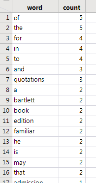

The pattern matcher can loop over a string and run your JSL as the match progresses.
text = // use the \[ and ]\ to escape the quotes in this text
"\[John Bartlett, who ran the University Book Store in Cambridge,
Massachusetts, was frequently asked for information on quotations and
he began a commonplace book of them for reference. In 1855, he
privately printed his compilation as A Collection of Familiar Quotations.
This first edition contained 258 pages of quotations by 169 authors,
chiefly the Bible, William Shakespeare, and the great English poets.
Bartlett wrote in the fourth edition that "it is not easy to determine in
all cases the degree of familiarity that may belong to phrases and
sentences which present themselves for admission; for what is familiar
to one class of readers may be quite new to another."  - Wikipedia]\";
words = [=> 0]; // an associative array that defaults  unknown keys to a value of 0
// this match repeats a pair of alternatives: a run of a-z or a run of NOT a-z.
// the runs of a-z are stored in an associative array
rc = Pat Match(
    text,
    Pat Repeat( // the loop starts here
        (Pat Regex( "[a-zA-Z]+" ) >> word
        +Pat Test( // insert word into words assoc array
            words[Lowercase( word )] += 1; // this JSL is evaluated for each word
            1; // the test must succeed for the pattern to continue
        )) | Pat Regex( "[^a-zA-Z]+" ) // skip non-words
// make a table, load it from the words assoc array keys and values
dt = New Table( "word count",
    New Column( "word", character, Set Values( words << getkeys ) ),
    New Column( "count", Set Values( words << getvalues ) )
// sort by the count column
dt << sort( by( count ), order( descending ), replaceTable );
Table of word countsTable of word counts
