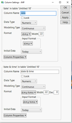

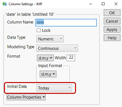

The"Initial Data" setting in the column menu is very useful.
Constand values, sequences, random values and
today.
One can even specify if "today" is just the date - or date and time:
amazing!

Please combine the approach of "initial data" with the functionality of input format - to define "default" values which will be used if no other value is specified in the current input:
With a setting like this one,
if the user enters 24.01., it will automatically be converted to 24.01.2024. If he enters 24., it will become 24.08.2024:
(view in My Videos)
Even more useful: Today as default setting - either via
or via the Format Pattern:
  1. then Jmp will behave like this:
     if no value is specified, Jmp will enter the current date.
