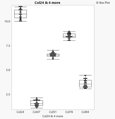

Fast Boxplots
When more than 3 columns are added to an axis in Graph Builder, the orientation of the plots (in this case, boxplots) is changed, and the scales are separated like you'd find in a parallel plot. This requires a novice user to do two things (s)he might not know to do: 1) Place the columns of interest on the axis opposite the one on which (s)he ulitmately wants the boxplots to appear and 2) change the axis setting to "Parallel Merged" by right-clicking the axis and selecting Combine Scales > Parallel Merged.
This addin automates all of this, so boxplots with combined scales can be immediately created.

Output:
A graph of boxplots with a common scale will be created.
