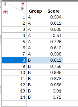

I have data with around 5000 rows.
There three columns (Group, Score and Count)
Value for Group: A, B
Value for Score ranging 0.5 - 1
Value for Count is 1 for each row.
I would like to summary the data by group A and B and group the Score value in few category and then sum the count for each score category , as below format.
I am seeking help from the community how to create JSL script to perform this task?
I attach data here as well.

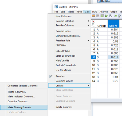

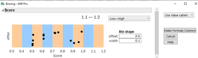

I selected the Score column, then navigated to Cols, Utilities, Make Binning Formula:
And set Offset to 0.5, and bin width to 0.1:

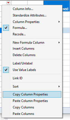

Right click the new column (Score Binned) and Copy Column Properties:
Then open a new script window and paste (ctrl-V), which results in this JSL:

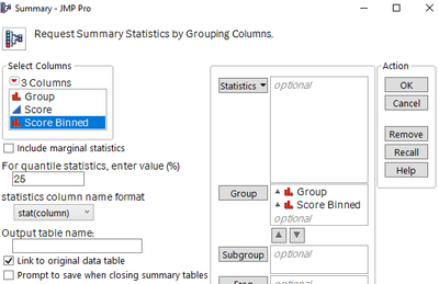

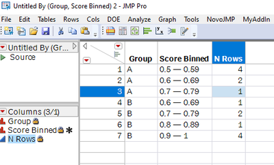

Now, back on our table, Tables > Summary takes us where we want to go. We put Group and Score Binned in Group, and that's all we actually need:

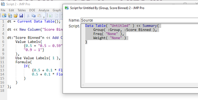

Now, N Rows is what we want, it's just named wrong, so let's double-click the word "Source" on the left and copy the table creation script and replace the named table reference with "dt", our working table, and catch the new table in the variable "summ":

summ = dt << Summary(
	Group( :Group, :Score Binned ),
	Freq( "None" ),
	Weight( "None" )
Finally, rename N Rows to "Total_Count" as desired:

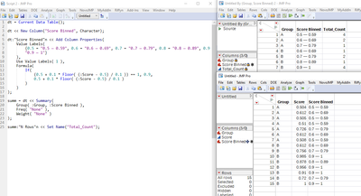

summ:"N Rows"n << Set Name("Total_Count");
Now, close the summary table, delete the Score Binned column from the source table, and test the script:

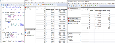

Final JSL again:
dt = Current Data Table();
dt << New Column("Score Binned", Character);
dt:"Score Binned"n << Add Column Properties(
	Value Labels(
		{0.5 = "0.5 — 0.59", 0.6 = "0.6 — 0.69", 0.7 = "0.7 — 0.79", 0.8 = "0.8 — 0.89", 0.9 =
		"0.9 — 1"}
	Use Value Labels( 1 ),
	Formula(
		If(
			(0.5 + 0.1 * Floor( (:Score - 0.5) / 0.1 )) == 1, 0.9,
	Freq( "None" ),
	Weight( "None" )
Tested on your attached data, which I literally just noticed :flushed_face:
Final JSL again:
	Value Labels(
		"0.9 — 1"}
	Formula(
		If(
	Freq( "None" ),
	Weight( "None" )
