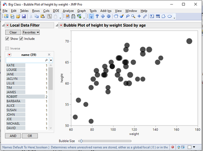

Sort categorical variables in local data filter (not alphabetically)
I notice that the Local Data Filter for categorical variables shows them in alphabetic order.
There is an option to order them by count, but I was after the option of sorting them by other variables.
In my case, I have a specific list I want to use as an order, but not sure how to do it.
Is there a simpler way than the following?

Re: Sort categorical variables in local data filter (not alphabetically)
Here is a script that uses the default Local Data Filter, along with the Value Order column property to accomplish what you are creating.  The script includes 2 methods for setting the order

txnelson
