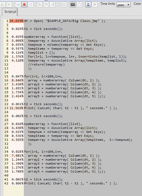

Craige_Hales
Re: Is there a quick way to make a large list without a for loop?
Nice performance test.
JSL has a profiler that can help answer performance questions:
I ran it to get this:
which tells me setting the values into the associative array is a bottle-neck in this code.  (line 10 vs line 11.)  (Line 23 probably includes opening the log the first time, ignore that; 42 is more representative.)
Big class only has 40 rows.  If you had many more rows (10K?) you might see other bottle-necks.  Don't call temparray<<getkeys twice.
It looks like you are trying to create a lookup table of small consecutive integers for each unique value in the column.  There may be a clever way to do this, but I don't see it right now.  Maybe someone else will...maybe some database join operation?
Craige
msharp
Super User (Alumni)
This profiler tool will come in handy.  Thanks for sharing it.
It looks like you are right, the reason it doesn't appear to run faster is b/c there are larger bottle necks in the code.  It does seem that the "::" matrix code runs faster than the for loop which is intuitive.  I get that from, comparing %'s in line 10+11 versus %'s in line 31.
My current code won't ever compare large sets of data, but I was still curious b/c I foresee building similar scripts for larger amounts of data and getting rid of for loops is a general sure fire way to make code faster.
