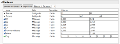

I’m doing a custom DOE and would appreciate any tips or pointers on creating optimal recipes.
Is there a better DOE approach than the one constructed, or other factors to bear in mind?
Responses:
  • Maximise  different nutritional values
  • Minimise quantity of salt
  • Reach target of  taste and smell score
Factors:
  • Categorical –> Texture 2 levels : T1 / T2
  • Categorical --> Aroma 3 levels: A1/ A3/ A3
  • Mixture
    • Ingredients to vary: C1 / C2 / C3 / C34
    • Ingredients that are constant (flavoured liquid). I have noted it two different values, even though it will be constant in the model, as JMP only accepts two different values
    • Water – this factor will be included when the sum of the constant ingredients and those to be varied equal less than 100 gr.
  • Blocking: Difference between days of panel testing (6 recipes to be tested / day)

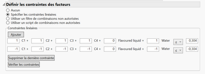

Defining linear constraints:
  • Two lines are added which maintains proportions between the constant ingredients (liquid = 69.6%) and the variable ingredients (C1 /C2 /C3 / C4 =30.4%)

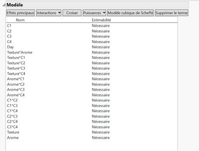

Model:

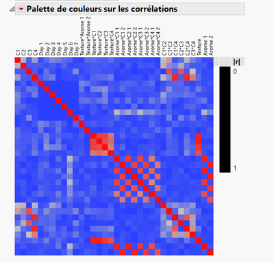

  • 2nd level interactions were also selected. To avoid a model singularity one of the ingredients in the ‘model’ parameters must be arbitrarily removed.
    • Water and Flavoured liquid were removed. 2nd level interactions involving either water or base were also removed (to decrease number of run and also as we are more interested in effets of the main ingredients)
  • Alias – all second level interactions

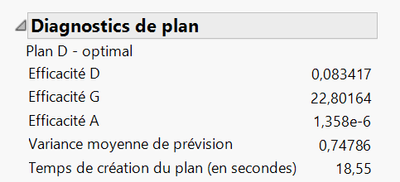

  • Maximum number of runs possible = 50 and with the above model the recommended number = 48 (so all good).
Example of runs:
Questions:
  • How is it best to determine the number of central and repeated runs ?
  • How do I interpret aliasing and the diagnostics ?

Thank so much for your answer and pertinent questions which I have responded to below (italics). Apologies for not being precise enough with the information!
For more context :  we want to investigate the different quantities of various chunks in soups. There are three different flavoured soups which all have the same chunks (chicken, beans etc). We have already some chef-created versions with a certain recipe and now we want to investigate how far we can push the nutritional aspect without decreasing acceptable sensory characteristics.
1. Question the measurement systems.  How precisely can they measure the nutritional values and salt?  You will have sensory measures for taste and smell (ordinal data sets like some hedonic scale).  How will you account for within and between assessor variation?  How will you account for assessor bias?
The assessors  will undergo training to reduce this bias. We will include a blocking factor for the difference between sensory sessions (days). We will accurately calculate nutritional (using an external laborotary).
2. I don't understand the 2 categorical factors?  What is the factor "Texture"?  Are you adding something to the batch?  What?  What is "Aroma"? Texture and Aroma sound like response variables, not X's.  Why 3-levels for your first experiment?
Texture category refers to the fact that we will either leave one version with the the ingredients in chunks and the other version will be mixed. The content will be identical.
Aroma category - three different flavour of liquid bases (same quantity) - chicken / vegetable / coconut
3. Mixture designs are what I consider to be optimization experiments.  Are you ready to do this?  Let's say the current process is performed in batches.  Which components of variation are most significant, within batch, batch-to-batch or measurement variation?  If you have significant batch-to-batch variation, you should figure out why before optimizing ingredients for 1 batch.
We have already 'optimised' our recipes to a certain extent through focus groups, testing and chef creation. We now want to optimise the nutritional component by seeing how far we can increase(protein) or decrease (salt) certain ingredients without affecting sensory characteristics.
We have 'reference' versions of these recipes which will serve as a guideline for desired level of various sensory characteristics (so we aim to investigate how much extra protein and how little salt can we use without decreasing acceptable taste and texture).
We have three categories of soup with a different liquid base and want to test how the ingredient chunks interact with the different liquids, hence the three aroma categories.
4. I don't understand the second bullet under mixture?  If there are 2 values, it can't be constant.
I have removed this element. All mixture factors are now variable (and I have also subsequently removed the linear contraint).

Following your comments I have adjusted the custom DoE (in attached pdf). In the model evaluation part it states aroma 1 and aroma 2 - is this because I have three categorical levels?
I don't follow your logic here? Although I notice you use French and I don't.
