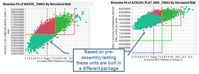

    Another common scenario requiring simulation is pre-assembly die sorting.  In this case, products may be built into different packages depending on their performance.  In addition to understanding overall bin mix, we now wish to understand what the mix will be for each package type, introducing an additional layer of complexity.  We also wish to understand how well our pre-assembly testing directs die to the correct package.  This is easy to do with the JMP script, because pass/fail data for every test and every bin is included for every die.  In the plot below we can see that die failing the wafer pre-assembly speed test (turquoise) are indeed among the slowest when tested after assembly to ACSCAN_PLAT_MIN_FMAX--but the correlation isn't perfect: the turquoise die overlap fairly heavily with other bin boundaries (note that this simulation uses different tests and bins than the previous example).
Whether this correlation is good enough to use in production depends on whether the resulting per-package bin distributions are acceptable.  The graphs below shows the difference between building all die (on the left) or all but the turquoise die (on the right).  For clarity, the corresponding graphs for bin mix distributions are not shown, but would be considered as part of the assessment.

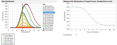

    A common, but somewhat more involved situation is when we wish to consider different bin limits; this occurs most often during the product definition phase.  There may be some uncertainty in what power to offer a customer, or the Design team may want to understand the implications of a piece of IP running slower than desired.  Our simulation script has the flexibility to vary bin limits in discrete steps; we can then study the distribution impact.  Because these analyses can be very different we do not generate special graphical outputs, but the distribution data are easily saved as separate data tables that we can study however we like.  The example below shows the standard output for "Bin 1 Combo" maximum distribution as the power limit is varied in 11 steps: the peak becomes lower and shifts to the right for tighter power limits.  (Bins 2-5 have only single curves because their limits do not change.  To the right we show a custom graph that plots Bin 1 distribution at the target process (vertical black line), as a function of the bin limit (labeled by step number; we can convert this to actual power values as needed).  As usual we could perform this analysis on the bin mix distribution too, if desired.

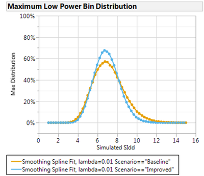

From the graph on the right we can see we have room to tighten the power limit by 3-4 steps before Bin 1 distributions start to drop off sharply; at that point the supply becomes very sensitive to minor changes.  We would feed this information back to the Marketing team as they consider what power specifications to offer a customer.
    We may also want to evaluate the speed sensitivity to a particular piece of IP.  We again step the bin limits and consider three metrics.  The first is the optimal process target (peak distribution location on the X axis): this is not infinitely tunable, and not trivially done, so we don't want the process target to be sensitive to speed loss.  We also need a reasonable process window (the range over which supply matches demand), and of course we need enough die passing that bin to meet customer orders.  All three of the graphs below tell a similar story: we can tolerate up to ~40 MHz speed loss, but beyond that the optimal process target is very sensitive to any speed variation, the process window rapidly shrinks, and the bin supply itself begins to collapse.  This input gives the Design team a clear criterion for success, and a solid feel for how much margin they should include in their simulations.
In particularly complex situations speed and power variations can be considered simultaneously; for example, if improving speed margin results in a power cost.  The scripting tool's built-in journaling is particularly important here, documenting all the changing inputs automatically.

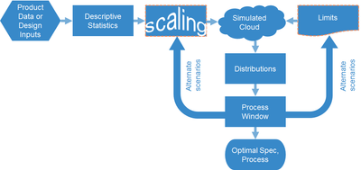

    The diagram below shows the process flow for a typical series of simulation runs.  We start with the predicted or actual performance characteristics, and from them extract the underlying statistical parameters describing the product; we may then scale these parameters (especially variance) to evaluate different scenarios.  At this point the Monte Carlo engine generates a simulated "cloud" of speed-power distributions.  Overlaid on this are the bin limits (customer requirements).  Numerically integrating the cloud volume within the limits determines the statistical distribution of bins for this particular cloud.  The scipt automatically repeats this across different manufacturing conditions to determine the process window over which the bin mix is acceptable (no nonsellable die).  At this point we may wish to consider different scenarios, in which case we can rerun the simulation with different scaling and/or limits, until we finally reach the optimal combination of process and limits for a given demand mix.

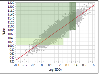

    The plot below shows a typical (simulated) speed vs. power plot for a single IP domain.  The frequency is nearly always a linear function of log(static leakage current = SIdd), so it is described by a slope, intercept, and RMSE (noise).  log(SIdd) itself is described by a mean and standard deviation.  Because we commonly evaluate standard deviation changes we include a scaling parameter as one of our inputs, which means the cloud has three parameters for power, plus three for every frequency test at each voltage and temperature.  In the plot below we show a sample bin limit: die below 0.32 logA static power and above 1040 MHz (inside the green box) are passing this bin's requirements.
  We can expand the number of passing die by adjusting the nominal test voltage (within the customer spec range).  At higher voltages parts run faster, so slower die can now pass the frequency requirement.  However, the part also consumes more static and dynamic power, and there is a fixed budget for that.  To stay within that budget the allowed static component at a fixed reference voltage must be lower.  The light green box in the picture below shows the additional die which pass the bin requirements at high voltage.  The reverse is true for lower voltages; the dark green box shows additional die captured under this scenario.

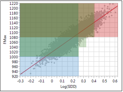

    Die that do not pass one bin, even with different voltages, may still pass another.  The plot below shows two additional bins that capture these outlier die: a low-speed, low-power bin (blue) and a high-speed, high-power bin (red).
    Of course many die can pass multiple specs; the next plot shows these overlapping regions, with die in the darkest green quadrant passing all voltages for the green spec limits, as well as the red and blue spec limits.  The binning regions are described by a combination of logical ORs across voltage, plus logical ANDs across temperature and IP domains.  These die can be used to flex supply as needed from one bin to another.

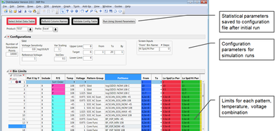

  We wish to contain all the myriad inputs for a simulation in one file for easy, consistent documentation.  In addition, we would like a script interface that will manage statistical extractions and actual simulation runs.  Fortunately, JMP can support all of this in a single data object, which we use for all of our inputs.  An example looks like this:
  The upper region is used for various scripting routines.  Because parameter names are often long and complex, we include the option to rename them to something less cumbersome using JMP's text parsing commands.  During the initial run based on a data file the script extracts and stores all of the necessary statistical parameters in the configuration file; future runs can simply use these stored parameters.  Users do not need to store the data file separately, allowing anyone to run an identical simulation using the product's configuration file.  This avoids inconsistencies when users base their analyses on different input data sets.
    The script also includes an option to validate the configuration table.  This is a critical tool to enable "first time right" simulations, because it checks for a host of potential errors that may produce spurious results.  Rather than relying on expert user review each time, the script ensures that no key inputs are missing (limits, tests, temperature or voltage grouping parameters, etc.), and also checks for more subtle errors that could produce bogus (but realistic-looking) simulations: perfectly-correlated parameters, nonphysical correlations, or bin/pattern/grouping combinations that guarantee zero or 100% distributions at all times.

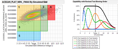

    The second, extremely common variation to explore is that of changing bin sort order; this can occur throughout a product's life cycle.  The plots below show the bin mix distribution across the manufacturing process when the sort order is: orange, red, light green, dark green, blue.  (The maximum distribution plot isn't shown here, since it's unaffected by sort order.)  At the process target (vertical black line) the orange bin dominates, with small amounts of light green and red-binned die, and virtually no blue or dark green distribution.
​We now wish to evaluate the effect of exchanging the red and dark green bins' sort order: how much less of the former and more of the latter will we now be able to ship?  Sort order is a parameter we can easily change in the configuration file, so this comparison only takes a couple of minutes to run; the plot below shows the result (note that the light green bin is completely covered by the dark green bin, which is tested first in the new order).
While the orange bin distribution remains unchanged, a significant portion of die (~30%) will now fall into the dark green bin rather than red or light green as before.  This result can be compared to customer demand to determine if the test program should be changed.
