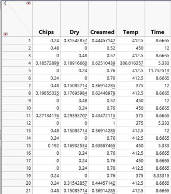

We also had several constraints. A portion of an experiment design with these constraints (see Figure 3) is shown in Figure 4.
Figure 3 – Creating the Design with Constraints
Figure 4 – A portion of our experiment design.

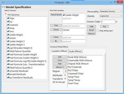

The Parametric Survival Platform
JMP's “Parametric Survival” platform uses Maximum Likelihood Estimation and offers the ability to analyze censored data. It is designed to work with “Time to Failure” responses – not cookie heights – but it turned out to be easy to get around that. When JMP asks for the “Time to Event” you simply choose “Cookie Height” as in Figure 5.
Choosing a Distribution
The Parametric Survival platform requires you to choose a distribution. The Normal distribution would have been our first choice, but that wasn't available. We chose the logNormal distribution because it has a great ability to impersonate the Normal distribution. Also, since we were near zero height, a Normal distribution might have modeled noise that would allow predictions of negative height (something you never want in a cookie!). The logNormal distribution avoids this nuisance.
Adding a “Censor” Column
Adding a censor column to the table allows us to tell JMP which runs contain censored data (data below the detection limit). It will treat these differently than the rest of the measurements. (It won't treat them as if they were zero – it will deal with them in a more sophisticated manner.)

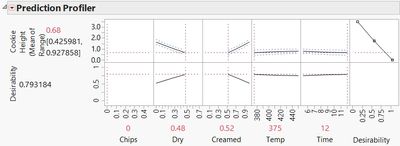

Optimizing the Recipe: Median vs Mean

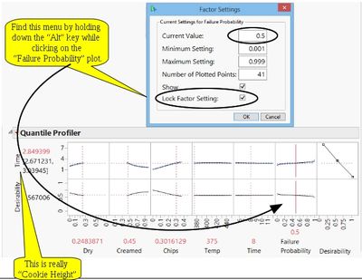

The Optimizer in the Parametric Survival platform treats “Failure Probability” as a factor. This is unnecessary for our analysis, so what should we set it at?
Usually in Response Surface Methodology, we are predicting the mean value. Since we are expecting the logNormal distribution to approximate the Normal distribution, the median should be pretty close to the mean. If we set the “Failure Probability” to 0.5 we should get what we need. Figure 6
Figure 5 – The Parametric Survival Platform
shows how to “lock” the “Failure Probability” at the median.
Also note that the response will always be labeled “Time.” Of course, you know it's really '”Cookie Height.”
You can add the “Desirability Functions” and set the Desirabilities as usual. You also find the “Sweet Spot” using “Maximize Desirability” as usual.
If you want to make contour plots, you will need to save the prediction formula and use the “Contour Profiler” under “Graph.”

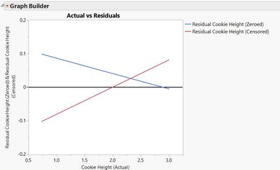

First, we dug up a really good ruler so we could know the actual cookie thickness (this was pretty hard and took a long time ). Then we were able to make an Actual vs. Predicted plot (see Figure 7). This didn't tell the whole story since it left out the noise. So we also created an Actual vs. Residuals plot (see Figure 8). Looking at the the two of these you can see that the results were similar. The residuals were of similar size with a different bias.
Next we predicted Sweet Spots with both models. Both models predicted essentially the same Sweet Spot, differing only slightly in the predicted baking time (see Figures 9 and 10). We baked 50 cookies for each Sweet Spot and compared the results (see Figure 11).

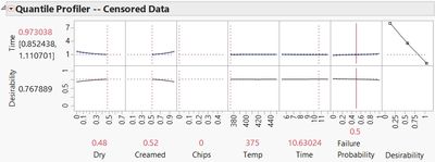

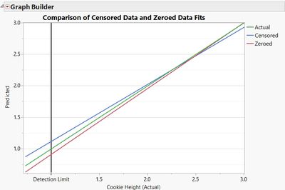

Figure 7 – Actual vs Predicted Curves

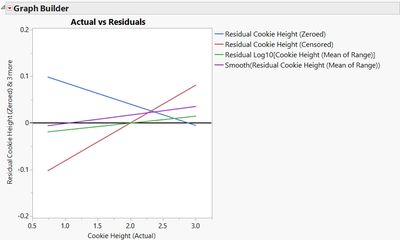

Figure 8 – Actual vs Residuals Curves

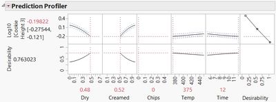

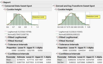

Figure 9 – The Sweet Spot for the Censored Data Analysis

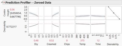

Figure 10 – The Sweet Spot for the Zeroed Data Analysis
The two Sweet Spots yielded the same cookie thickness. We found essentially the same Sweet Spot with both models, so the analysis technique didn't matter for finding a Sweet Spot.
Take a closer look at Figures 9, 10, and 11. Although they predicted the same Sweet Spot, the actual prediction of the censored model was more accurate. Even the confidence limits for the censored model prediction were closer to reality. So if you need accurate predictions, the censored model is better.
Figure 11 – Sweet Spot Comparison
Figure 14 – Actual vs Residuals Plots for All Three Models
You can see that both the censored data model and the log transformed model predicted pretty well – the censored model predicted a little high, the log transformed model predicted a little low. It looks like using the logNormal distribution was not necessary.
Figure 6 – The Quantile Profiler

Figure 13 – The Sweet Spot for the Mean of Range Analysis
